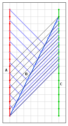

  • #37
ghwellsjr said:
But the inverse nature of the two Dopplers is not classically contradictory as you have incorrectly concluded. Once you figure that out, maybe you'll have a different assessment.
This seems to be the central point. The disagreement isn't over the fact that (Da/Db)(Db/Dc) = Da/Dc = 1, but rather over the claimed equality (by relativity) Dc/Db = Db/Dc, which you use to claim that Da/Db and Dc/Db are recipricals. In other words, you rely on the relativistic fact that two inertial observers both see the same Doppler shift of signals from the other. Classically this equality doesn't unambiguously hold. Here's why:
We have two inertial clocks A and B with some mutual velocity v, and we assert the two principles of (1) relativity between inertial coordinate systems, and (2) independence of light speed from the speed of the source (again in terms of any inertial coordinate system). On this basis we can examine the relationship between the frequencies of light signals transmitted and received by the clocks in terms of (for example) the rest frame of A, in which the other clock B has velocity v.
Now, by the classical Doppler effect (meaning no relativistic time dilation of B relative to the time coordinates of A's rest frame), it's trivial to see that the light-speed principle implies that a signal sent from A with frequency fA will arrive at B with frequency fB where fB/fA = 1-v, whereas a signal sent from B with frequency FB will arrive at A with frequency FA where FA/FB = 1/(1+v). These two ratios are not equal, but the relativity principle requires them to be equal, so classically the two principles are irreconcilable.
The only way of reconciling those principles is that clock B must not advance equally with the coordinate time of A's rest frame. Specifically, clock B must advance more slowly by the time-dilation factor sqrt(1-v^2). Accounting for this difference in the rate of B, we find that the two ratios are
fB/fA = (1-v)/sqrt(1-v^2) and FA/fB = sqrt(1-v^2)/(1+v)
Both of these equal the relativistic Doppler factor sqrt[(1-v)/(1+v)], so we have satisfied the relativity requirement. Note that the time dilation factor applies regardless of whether A and B are approaching or receding from each other, and of course the Doppler effects in those cases are reciprocals.
The relativistic time dilation factor, which is necessary to logically reconcile the principles, automatically enables us to compute (quantitatively, not just qualitatively) the different ages of the twins, so nothing more is needed, and nothing less suffices. I think a student would accept your version of the Doppler explanation only if he failed to realize that the premises are mutually contradictory unless we posit relativistic time dilation, and once we do that, nothing else is needed. Also note that no third clock is needed. At best the Doppler considerations provide just one more derivation of the time dilation factor, but of limited applicability, and without clearly defining how that fits with the Lorentz transformation. As such, it will certainly seem unsatisfactory to the student when he realizes that not only must B run slow in terms of the standard time coordinates of A's rest frame, but A must run slow in terms of the standard time coordinates of B's rest frame. The only way to really understand this is to understand how inertial coordinate systems are related to each other, in full (i.e., the Lorentz transformation).

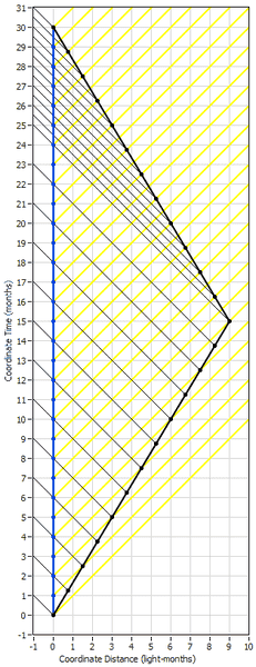

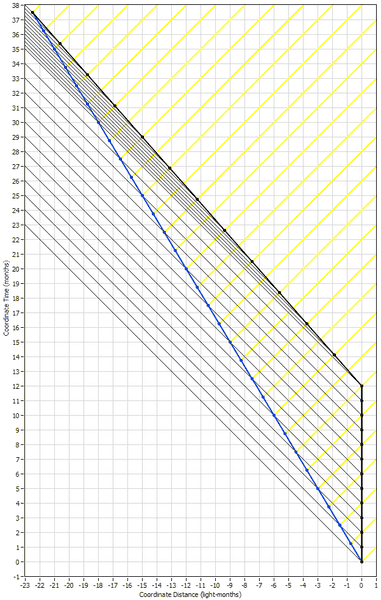

  • #38
PeterDonis said:
ghwellsjr said:
Was the math of post #2 within your grasp?
It's not just the math of post #2; the OP needs to understand why the math of post #2, as you presented it, only applies to the traveling twin, not the stay-at-home twin. There is also a corresponding equation that applies to the stay-at-home twin, with the same ratio R in it, but it differs from the one you gave in post #2 in a crucial respect. What that crucial respect is is not a question of math, it's a question of physics. Post #2 gives a hint at the answer to the question of physics, but you didn't give it explicitly.
I don't know if this is what you are referring to but if, or rather since, (R+1/R)/2 is the ratio of the stay-at-home twin's accumulated age compared to the traveling twin's accumulated age, then we can say its inverse, 2/(R+1/R), is the ratio of the traveling twin's accumulated age compared to the stay-at-home twin's age. In other words, its from the perspective of the stay-at-home twin looking at the traveling twin and we did this without knowing hardly anything at all.
But we do know something else which is that unlike the traveling twin who immediately sees a change from R to 1/R in the Doppler signal coming from the stay-at-home twin, the stay-at-home twin will not immediately see a change in the Doppler signal coming from the traveling twin but rather the Doppler will remain at R for a longer time than it remains at 1/R. And it's easy to calculate the exact fraction of time for R and 1/R.
Let's call F the fraction of the total trip time as measured by the stay-at-home twin that he observes a Doppler of R coming from the traveling twin. This means that the fraction of the total time that he observes a Doppler of 1/R must be (1-F) because the total time must be the sum of the two fractional parts. And if we multiple each of these fractions by their respective Doppler factors and add them together, they must equal the total of 2/(R+1/R). Now we can write an equation and solve for F as a function of R:
FR + (1-F)/R = 2/(R+1/R)
(FR2+1-F)/R = 2R/(R2+1)
FR2+1-F = 2R2/(R2+1)
F(R2-1)+1 = 2R2/(R2+1)
F(R2-1) = 2R2/(R2+1)-1
F(R2-1) = (2R2-R2-1)/(R2+1)
F(R2-1) = (R2-1)/(R2+1)
F = 1/(R2+1)
The other fraction is merely (1-F):
1-F = 1-1/(R2+1) = (R2+1-1)/(R2+1) = R2/(R2+1)
And of course the sum of the two bold terms is 1.
This was pure math so I don't know if it is what you were driving at. Could you enlighten me?

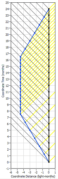

  • #39
This is what I was referring to; the fraction F for the stay-at-home twin is different than it is for the traveling twin. For the latter it's just 1/2, since the Doppler changes when he turns around halfway through the trip. That's the key item of physics that I was talking about; the traveling twin observes the change in Doppler as soon as he turns around (because his turning around is what changes it), but the stay-at-home twin doesn't observe the change in Doppler until light from the turnaround point reaches him. This is a key aspect of the scenario that is not symmetric between the twins.

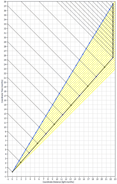

  • #40
ghwellsjr said:
And it's easy to calculate the exact fraction of time for R and 1/R... And if we multiple each of these fractions by their respective Doppler factors and add them together, they must equal the total of 2/(R+1/R).
That isn't legitimate, because you're simply assuming your result, and then backing out whatever fraction is needed to give you that result. What you would really need to do is compute the result from the perspective of the stay-home twin from the same principles that are used to compute the result for the traveling twin, rather than simply assuming that the results are reciprocals of each other. This means you need to derive the fraction F from first principles, and then show this leads to the result 2/(R+1/R), rather than simply assuming the latter result and claiming that F just happens to have whatever value it needs to have in order to give that result. This will require you to actually quantify your reasoning about speeds, spatial distances, time intervals, and inertia, because ultimately that's the difference between the twins - one follows an inertial path and the other doesn't - so any valid explanation has to invoke the concept of inertia in some form.

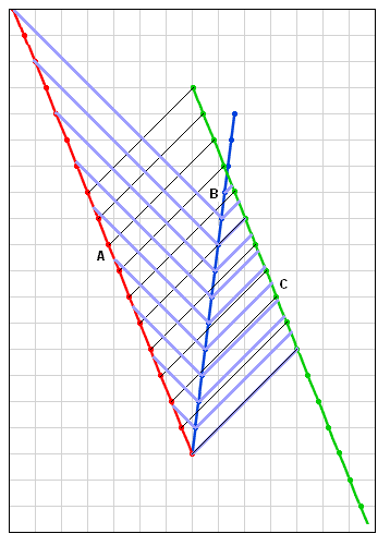

  • #42
Samshorn said:
I didn't assume my result--I had no idea what it was going to be--and I was surprised at what it turned out to be.
I don't understand your objection at all. If I can correctly determine that A sees B's clock accumulate Q times the amount of time on his own clock, then there can be no other answer than B sees A's clock accumulate 1/Q times the time on his own clock. Why is this controversial?

The horizontal axis is distance and the vertical axis is time.
Here is that explanation:
ghwellsjr said:
Let's say that you are looking at two observers with clocks. One of them is a fixed distance away from you so you will see his clock ticking at the same rate as your own. They may have different times on them but we don't care about that, we only care about tick rates. The second observer is traveling at a constant speed from the first one directly toward you. Therefore, you will see his clock ticking faster than yours. You also know that you are seeing time progress on the traveler's clock compared to the first observer's clock just as the traveler is seeing them but delayed in time, provided that the light from both clocks travels towards you at the same speed. Therefore the ratio of the tick rates that you see of the distant fixed clock to the traveler's clock is some ratio that we called R. But the ratio of the tick rates that you see of the traveler's clock compared to your own (which is the same as the distant fixed clock) is the inverse of R.
You are the green observer C. You are looking at the clocks of the red observer A and the blue observer B. The red observer A is stationary with respect to you but both of you are traveling in the medium at the same speed. The blue observer, B, is traveling at some unknown, arbitrary speed from observer A towards you, the green observer C. The tick of each clock is represented by a colored dot.
In this example, you see blue's clock ticking three times faster than your own as depicted by the pale blue signal lines coming from his tick dots toward you. But you receive three of his for every one of your tick dots.
You can also see the same thing that the blue observer sees when he looks at the red observer's clock compared to his own, just delayed in time, namely that blue sees red's clock ticking at 1/3 the rate of his own clock. This is depicted by the black lines coming from each of red's tick dots and impinging on blue's tick dots but only every third one.
The two Doppler effects that I was talking about are your observations of B's clock compared to your own (3, in this example) and A's clock compared to B's clock (1/3, in this example). You can pick any other example and you will get the same result that the two Doppler factors are inverses of each other. And it doesn't matter if you consider classical Doppler or Relativistic Doppler or if you consider that the observers are moving with respect to a medium or stationary in it.
OK, got that? Please do not misrepresent what I said again. Of course if you think I am mistaken, then you're going to have to offer some proof--a diagram would be good.

If this example is correct, it shows B seeing a slower clock rate for A than A sees for B. That would mean the classical doppler is not symmetrical.
https://www.physicsforums.com/attachments/58741
  • #46
Actually, I didn't show A watching B but I have added it into this drawing:
It turns out that A sees B's clock ticking at 1/3 his own just like B sees A's clock so in this case, it is symmetrical but that's because A and B are both traveling at the same speed in opposite directions with respect to the classical medium and so the ratio is 1 as your document states.
Later on, I'll upload some more examples where A and B are traveling at different speeds so the ratio of their Dopplers will not be 1 and yet B's Doppler observation of A is the inverse of C's Doppler observation of B. That, after all, was the point of the drawing, not any symmetry or non-symmetry anywhere else.
I have two more examples. Here's the first one:
https://www.physicsforums.com/attachment.php?attachmentid=58761&stc=1&d=1368690498​
In this example, A and C are stationary with respect to the medium and B is traveling at one-half the speed of a signal in the medium. You can see that B observes A's clock ticking at one-half the rate of his own and C can also observe this. You can see that C observes that B's clock is ticking at double the rate of his own. These two ratios are inverses of each other which is the point that I have been making, for all Doppler ratios, whether classical or relativistic, as long as the speed of the signal is independent of the source.
Now to the issue that you brought up, B observes A's clock ticking at one-half the rate of his own clock but A observes B's clock ticking at two-thirds the rate of his own clock.
A second example:
https://www.physicsforums.com/attachment.php?attachmentid=58762&stc=1&d=1368690498​
In this example, A is traveling to the left at 40% of the speed of signals in the medium and B is traveling to the right at 12.5%. As a result, B sees A's clock ticking at 5/8 of the rate of his own clock. And C sees B's clock ticking at 8/5 the rate of his own.
And A observes B's clock ticking at 8/15 of his own clock.
Does this all make sense? Can you see that the only time A and B have a symmetrical measurement of the other ones clock with respect to their own is when they are both traveling in the medium at the same speed.

Does this mean you have down graded your assessment of my first post from "total bull" to just "bull"?
Keep in mind, the OP never asked about Time Dilation or simultaneity issues. He just wanted to know which of the two brothers would be older since motion is relative. And I gave him an answer to that question.
But since you suggest that spacetime diagrams make it very obvious, I will provide some. First, for the Inertial Reference Frame (IRF) in which one brother (depicted in blue) remains at rest and the other brother (depicted in black) travels away at 0.6c for 12 months and then returns at the same speed for the same length of time for a total time of 24 months and finds his other brother has aged by 30 months. The dots on each brother's worldline mark off 1-month intervals and signals traveling at the speed of light are sent by each brother towards the other brother:
In this diagram, it is very obvious that the blue brother's time is not dilated whereas the traveling black brother's time is dilated. His dots marking off 1-month intervals of time are stretched out compared to the Coordinate Time of the IRF by a factor of 1.25 which is the value of gamma at a speed of 0.6c.
The diagram also clearly shows the symmetric Relativistic Doppler that both brothers observe of the other brother's time--it takes 2 months before they each see the other ones clock turn over 1 month.
At the moment of turn-around the Coordinate Time is at 15 months and the traveling black brother immediately sees the Doppler factor change from 1/2 to its inverse, 2. Up to this point, he has seen his blue brother age by 6 months but after this point, he sees his brother age by 24 months for a total of 30 months. However, the blue brother at rest does not see anything differently but continues to see the Doppler factor at 1/2 until month 24 and at this point he sees his brother turn around and start heading for home. Now he sees the Doppler factor change from 1/2 to 2 for the remaining 6 months. So the blue brother sees his black brother age by one year during two years of his time and then he sees his brother age by another year during just one-half year of his own time for a total of two years or 24 months.
Next is the IRF for the rest state of the traveling brother during the first half of his trip which we obtain by using the Lorentz Transformation on the coordinates of events in the original IRF to get a new set of coordinates:
Now we can see that the blue brother, who is at rest in the first IRF is traveling at 0.6c to the left in this IRF and so his clock is Time Dilated by the 1.25 factor during the entire trip. However, neither brother has any awareness of this, they continue to see everything the same as it was depicted in the first IRF. And what do they see? The black brother sees his blue brother age by six months during the first half of his journey and by 24 months during the second half of his journey. And the blue brother sees his black brother age by 12 months during 24 months of his own progress and then by another 12 months during the last 6 months of his own Proper Time. Note that there is no new information depicted in this IRF.
For the last IRF, we have the traveling black brother at rest during the last half of his trip and this time the blue brother is traveling to the right at 0.6c and his clock is Time Dilated during the entire trip by the gamma factor of 1.25:
And once again, although the Coordinate Time is 25.5 months at the turn-around event, this is not observable by either brother but all the other observations mentioned for the first two IRF's apply exactly the same in this IRG. Just read the previous descriptions while looking at this IRF and you will see that this is the case.

Radar measurements just don't give a sufficient picture when the radar itself is moved... Your last graphic is particularly indicative about that with how nonsensical it is. The vertical section of the blue line is completely random, indicating that the blue twin traveled in parallel to the black twin for no particular reason. You could just as well make it curved, zig-zag or make it spell your name in that segment.
  • #55
There is only one way for the non-inertial twin to use the radar measurements to generate the diagram. It's not random. It's not nonsensical. And there is no way he could have made that portion curved, zig-zag or spell any name. If you don't know what the process is, you can see how it is done on my posts on this page:
https://www.physicsforums.com/showthread.php?t=644948&highlight=triplets&page=6
But you're welcome to show me, if you are so sure about your position, how you would follow the radar method to spell out "geo". Show me, don't just make an idle claim.

  • #57
But you do not have a uniformly accelerating radar nor an inertial radar. You have instant acceleration - i.e. infinitely strong acceleration for zero duration here. You can approximate it with a uniform acceleration for a short time, but then the blue line should not have any angles in it, it will be a gradual curve. It will be a perfect hyperbola if you assume constant acceleration. It will be any shape you want if you assume some other type of acceleration profile.
EDIT: ok, not "any shape you want". maybe it will not be possible to spell your name with hyperbola fragments. but still can vary quite a bit and showing it as a straight line is quite random.
EDIT2: actually, please do explain to me, how do you 'radar' something beyond the apparent event horizons that appear when you are accelerating? as even if you approximate the instant acceleration with a gradual acceleration, it is still a very large acceleration and the event horizons will be terribly close...
  • #58
Which is fine. The radar coordinate convention is adapted to arbitrarily accelerating observers. It is merely a nice feature that it reduces to the Rindler and Minkowski coordinates for the appropriate observers, not a restriction.
Not random at all. Random means that for the same input the output is unpredictable. The radar coordinates are not random at all, they always produce the same output for a given input.
They are well defined and ghwellsjr has correctly drawn them. Each successive radar pulse that is sent and received prior to the acceleration is longer than the previous, so the radar distance is increasing. Each successive radar pulse that is sent and received after the acceleration is shorter than the previous, so the radar distance is decreasing. Each successive radar pulse that is sent before and received after the acceleration is the same duration as the previous, so the radar distance is constant. As shown by ghwellsjr.
See figure 9 here:
http://arxiv.org/abs/gr-qc/0104077
You might want to re-think your objection. What really bothers you about it? You probably assume that the inertial twin's worldline must have a single bend in it, but why did you assume that? Perhaps that assumption is not as solid as you might think.
You stop accelerating. The horizons only exist if you undergo constant acceleration forever.
