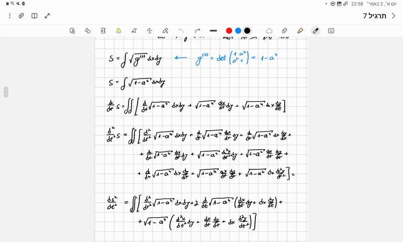

i attach here the calculation in the photos.
This is how i understood to take the second derivative respected to time. I understood that dx and dy are also being effected.

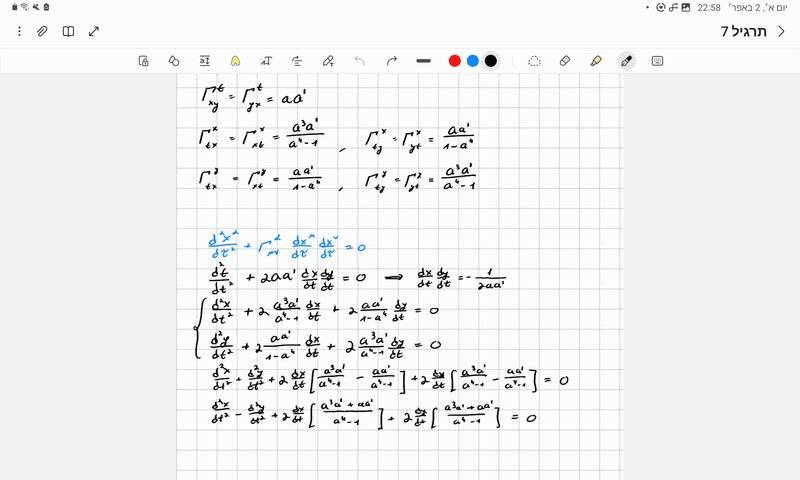

I also show there the Geodesic equations i have calculated using the Christoffel symbols.
can you please explain what overall sign i lost in the Christoffel symbols?
  • Handwritten derivation of a surface area integral S with respect to a parameter t, showing repeated differentiation of sqrt(1 - a^4 ...) terms with product rule applied to dx and dy.

  • Handwritten notes on grid paper listing Christoffel symbols Gamma with superscripts and subscripts, then geodesic equations d²t/dτ² + 2aa' dx/dτ dy/dτ = 0 and a system of coupled second-order differential equations in x and y.

I'll double check my Christoffel symbols.
The problem with your approach to the derivative of the area is that I think the limits of integration are time dependent, so you need to carry out the integral before computing the derivative, I think.
Rechecked my Christoffel symbols and you are correct - apologies. I missed that you'd taken the minus sign into the denominator.
Thank you very much for responding. i am not sure i understood what you are saying about the derivative of the area. I carry the integral all the way.
the integration of the integral should be:
for y: $$ -\sqrt{R^2-x^2}<y<\sqrt{R^2-x^2}$$
and for x: $$-R<x<R$$
That's how i understad it so farm, so what do you mean by saying they are time dependent?

The point is that ##R## depends on ##t##, so I don't think ##\frac{d^2}{dt^2}\int\sqrt{g^{(2)}}dxdy## is the same as ##\int\frac{d^2}{dt^2}\sqrt{g^{(2)}}dxdy##.
In any case, do you have an expression for ##R(t)##?
I understood it is not the same, this is why I used the derivation of a product rule and got the expression i got. (I attached a photo of how i got it).

I'm struggling to read your screenshots on my phone. Deriving the geodesic equations myself, I now think that the particles do not change coordinates, so their positions always satisfy ##x^2+y^2=R^2## where ##R## is an arbitrary constant, nothing to do with any tensor.
I think you are supposed to be calculating the second derivative of the area enclosed by the ring of test particles, which is the region defined as ##x^2+y^2\leq R^2##. I don't understand why you don't do this integral directly - neither ##a## nor ##R## is a function of ##x## or ##y## so it looks to me to be trivial. Then you can simply differentiate; I assume this will lead you to something that looks like the Ricci scalar.
