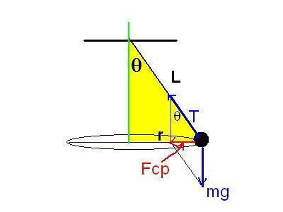

1. A conical pendulum has length 1.5m and rotates at 4ms^-1. What is its angle to the vertical?

1. I've drawn a diagram and understand that i have gravity acting downwards and tension up the string. I think i could find θ by using tanθ=v^2/rg but I am not sure of how to work the radius out if i only have the length of the string, the velocity, and gravity.
Look at your diagram (or the yellow triangle on the attached picture): how is the radius r related to the length of the string and the angle θ?
ehild

so the force of gravity is (m)(-9.8) only in the y direction which means the y component of the tension must be (m)(9.8). the only two forces acting are gravity and tension so the x component of the tension must be providing the centripetal force on its own. so i drew a diagram for tension and ended up with (9.8)tanθ=v2/r and that's as far as i made it so far without knowing angle θ
navm1 said:
(9.8)tanθ=v2/r
Right so far. You know v and the length of the string. What other equation can you write relating these with θ and r?
navm1 said:
… (9.8)tanθ=v2/r and that's as far as i made it so far without knowing angle θ
you know L = 1.5, so what's the relation between L r and θ ? :wink:
i don't know if I am going down the route you guys have suggested but i ended up changing my equation from
(g)(tanθ) = v2/r
to
sinθ/cosθ = v2/(l*sinθ)(g)
then i think i could square the sinθ and start to build a quadratic equation from there?
if i multiplied both sides by sinθ would i end up with
sin2θ/cosθ = v2/lg ?
edit: or could i replace sin2θ with 1-cos2θ
so if x = cosθ
then my equation is x2+(v2/lg)*x-1=0. v2/lg
i came out with x=0.6 so cos-1 would be 53.1°
which would make the vertical angle 36.9°
am i on the right track here? thanks
navm1 said:
(g)(tanθ) = v2/r
navm1 said:
so if x = cosθ
yes! :smile:
