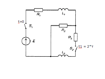

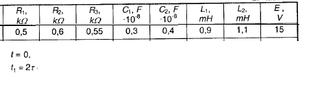

I have to calculate first commutation process (t=0) and second commutation process (t1 = 2*τ)
Circuit schematic of two RL branches with switches S1 at t=0 and S2 at t1 = 2*T, a voltage source E, resistors R1, R2, R3 and inductors L1 and L2.
Table of circuit component values: R1 0.5 kΩ, R2 0.6 kΩ, R3 0.55 kΩ, C1 0.3 ·10^-6 F, C2 0.4 ·10^-6 F, L1 0.9 mH, L2 1.1 mH, E 15 V; below it t = 0 and t1 = 2τ.
Both swithes are closing in the given time moment.
Form of second commutation process:
Equation for the inductor current iL2(t) after the second switching instant: (t - t1) times the sum of A1 exp(p1(t - t1)), A2 exp(p2(t - t1)) and iL2(t) in parentheses.

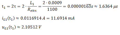

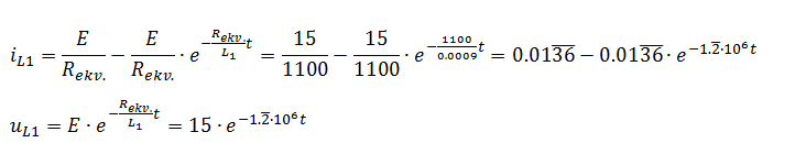

I have already calculated first commutation process:
Circuit schematic of a series RL circuit: voltage source E with switch S1, resistor R1, inductor L1 and resistor R2 in a single loop.
Handwritten-style derivation of the inductor current i_L1 = E/R_ekv - (E/R_ekv)e^(-R_ekv t/L1) = 15/1100 - (15/1100)e^(1100/0.0009 t) = 0.0136 - 0.0136e^(-1.2*10^6 t) and inductor voltage u_L1 = E e^(-R_ekv t/L1) = 15e^(-1.2*10^6 t).
And also some important figures for second commutation process:
Worked calculations: t1 = 2τ = 2·L1/Rekv = 2·0.0009/1100 ≈ 1.6364 μs; iL1(t1) ≈ 0.0116914 A = 11.6914 mA; uL1(t1) ≈ 2.10512 V.

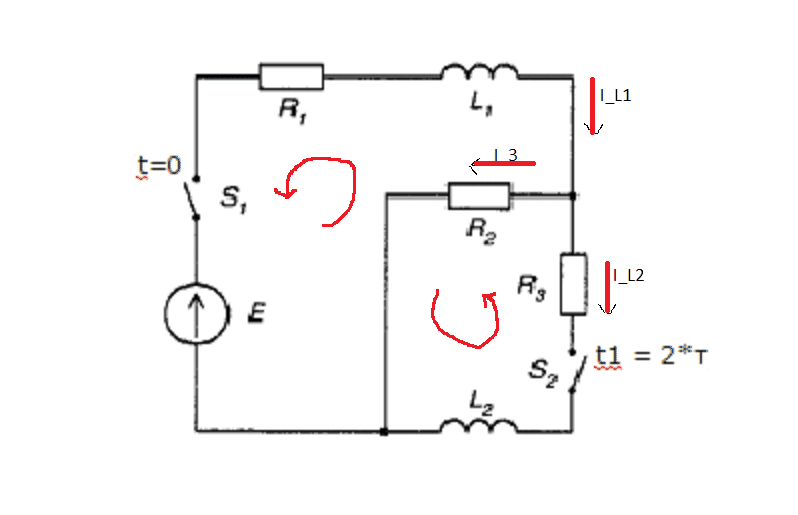

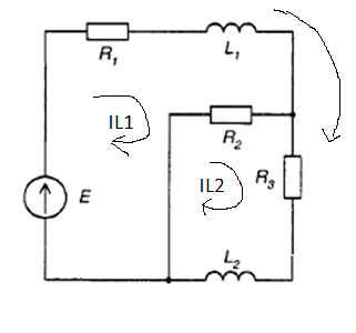

But how to get final result of second commutation process?
Circuit schematic of an RL network with a voltage source E on the left, resistors R1, R2 and R3, and inductors L1 and L2, with mesh currents IL1 and IL2 marked by curved arrows.
I have to use mesh current method and write 2 equations (loops with current IL1 and IL2 in the picture) and after that I have to calculate complicated system of differential equations or what?
What you have to do depends upon what it is you want to find. What do you mean when you say "calculate a commutation process"? Is there a particular voltage or current function that you need to find? What was the exact problem statement?
I guess, I wasn't formulated my problem.
So.. I have to calculate current through the inductor L2 and voltage across the L2, when switch 1 is closed in the time moment t=0, and switch 2 is closed in the time moment t = 1.6364 us (as I calculated).

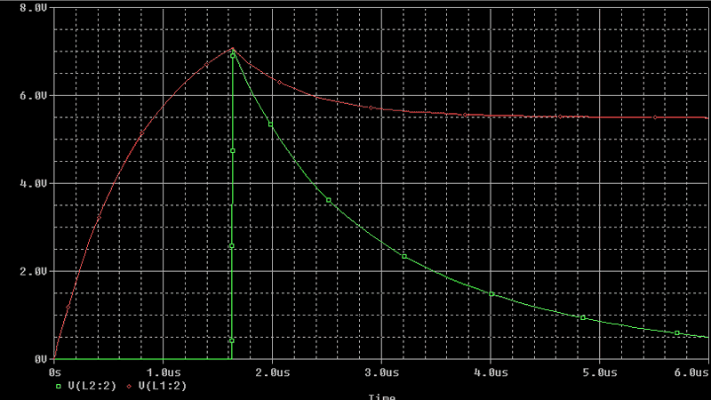

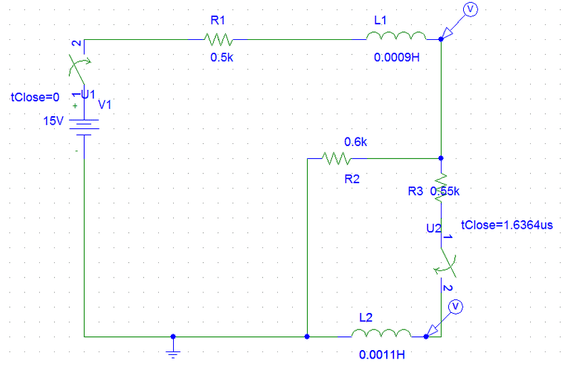

I tried to simulate my task using PSpice:
Schematic of a PSpice circuit: 15V source V1 with switch U1 (tClose=0) feeding R1 0.5k and L1 0.0009H in series, then R2 0.6k and R3 0.55k with switch U2 (tClose=1.6364us) feeding L2 0.0011H back to ground.
And here is results of voltages:
PSpice transient plot of two voltages against time from 0 to 6 us, showing V(L1:2) as a red curve rising to about 7 V near 1.6 us then decaying to about 5.5 V, and V(L2:2) as a green curve that jumps to about 6.9 V at 1.6 us then decays toward 0.5 V.

Am I wright, that I have to use mesh current method and write equations, including dIL1/dt and dIL2/dt?

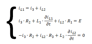

Here is my attempt:
Circuit schematic with source E, switch S1 at t=0, resistor R1 with inductor L1 in the top branch, resistors R2 and R3 with inductor L2 and switch S2 at t1 = 2*T in the lower loop, with currents I_L1, I_L2 and I_3 marked and two hand-drawn loop arrows.
System of three equations: iL1 = i3 + iL2; i3·R2 + L1·(d iL1/dt) + iL2·R1 = E; −i3·R2 + iL2·R3 + L2·(d iL2/dt) = 0.
Is this correct? And to get IL2(t) I have to calculate this complicated system of differential equations?

Here is my attempt:
Hand-annotated circuit schematic with source E and switch S1 at t=0 on the left, resistor R1 and inductor L1 on the top branch, resistors R2 and R3 and inductor L2 in the lower branches, switch S2 marked t1 = 2*T, and current labels I_L1, I_L2 and I_3 with red loop arrows.
System of three equations in braces: iL1 = i3 + iL2; i3·R2 + L1·(d iL1/dt) + iL2·R1 = E; −i3·R2 + iL2·R3 + L2·(d iL2/dt) = 0.
Those are KVL/KCL equations (you've labeled individual currents for each branch). The second equation doesn't look right; iL2 doesn't flow through R1.

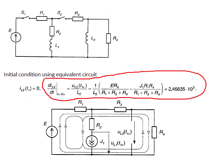

So, it means, that I have to find initial conditions for I_L2 before I have started to calculate differential equation.
And here is my problem, I don't know, how exactly I can find it.
I know, that in my case I_L2(t1)=0, but I have to find dIL_2/dt in the time moment.
I have got an example. There is standart cicuit and after that - equivalent cicuit. It looks, that this example is very simular to my circuit. But still I don't understand, how exactly I can find this value. I circuled an expression in the example. I have to do the same with my circuit.
Circuit schematic with source E, switches S1 and S2, resistors R1 to R4, inductors L1 and L2, and an equivalent circuit below with current source J1, plus a handwritten-style derivation of di/dt at t=t1+ equal to 2,46835 x 10^3.
So.. can you explain, how to get this value?
To be clear.. it's initial conditon for my second order differential equation. I converted my system of differential equations to second order differential equation and using it, I will find I_L2(t). As I said, I know IL_2(0) = 0, but I have to find dIL_2/dt(0) like in the example. To say easier: x(0)=0, x'(0) -?
I hope that you understand my problem.
Since inductor currents cannot change instantaneously at commutation, for purposes of analyzing the situation at that instant they replaced L1 with a current source equal to the current through L1 at that instant. They also "removed" L2 since it will look like an open circuit at that instant. Then they used superposition to determine the potential ##U_{L2}(t_{1+}) across L2:
1) Current source suppressed: R1,R2, and R3 form a voltage divider for E.
2) Current source suppressed: Current divider to find current through R3+R4 branch, then multiply by R4 to find the potential across L2.
3) Sum the contributions.

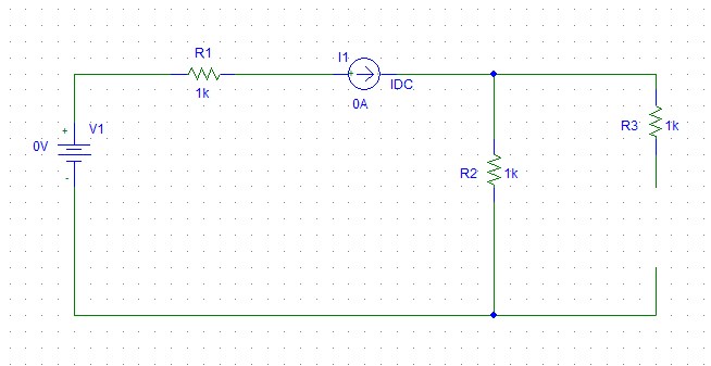

My circuit:
Circuit schematic of an RL network with a voltage source E and switch S1 at t=0, resistors R1, R2, R3, inductors L1 and L2, and switch S2 at t1 = 2*T.
I guess, then equivalent circuit should look like that (without given/real values):
Circuit schematic with a 0V voltage source V1 feeding R1 (1k) in series with current source I1 (IDC, 0A), then a node driving R2 (1k) down to the bottom rail and R3 (1k) on the right branch.
In my case:
Voltage divider:
Fraction showing U times R2 divided by the sum R1 + R2, written as a formula for two resistors in parallel or a voltage divider.
Current divider:
Fraction with numerator J R2 and denominator R2 + R3, written as a handwritten or typeset expression.
I have to sum these equations? But it seems to me, that I am not on the right track..
No, you're doing very well :smile:
Here's a hint that may help. Any components in series with a current source are irrelevant. A current source will produce its designated current no matter what; It will generate any amount of voltage necessary to get that job done. So R1 and V1 in your circuit make no difference and you can remove them, leaving just the current source driving current through R2, the only available complete path. That should make determining the potential across the "L2 open" very easy indeed.
Then voltage across R2 is V = J * R2 and it's the same in the branch, where is R3 and "L2 open". To find voltage drop across "L2 open" I should from J*R2 subtract current divider? Or actually current divider is output of branch where is L2?
Ouch, sorry.. it becomes awkward.. not good day for my thinking.

There's no current divider in this case; all the current is flowing through R2. So the potential across the "open" is the same as the potential across R2.
Thanks. Alles klar. :)
Already solved differential equation.
