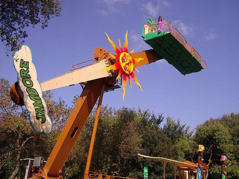

Indeed, it is also not always true of a pendulum either:
If you refer to the "balcony", it is possible that in some regimes it approximates pure translation.
This is what I was trying to ask in my original post. The "balcony" is actually translating and therefore has no angular velocity, correct? This is because every point on the rigid body of the "balcony" has equal velocities.
In order to have angular velocity, the "balcony" would have to have unequal velocities on its body.
Someone also mentioned something about the Hubble space telescope. If this is actually pointing in the same direction while orbiting earth, then it is in translation (zero angular velocity) correct?
Correct me if I'm thinking about this wrong, but a rigid body has angular velocity if and only if all of the points on the body don't have equal velocities.
