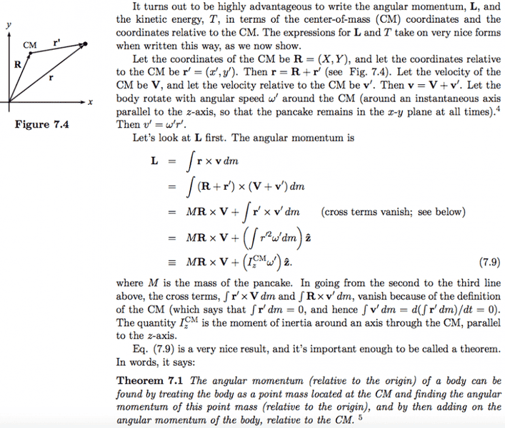

Consider a flat 2D rigid body rotating about an axis perpendicular to the body passing through a point P that is
(1) in the same plane as the body and
(2) different from the body's center of mass (CM).
In this case does Theorem 7.1 (eqn 7.9) still apply?
In the last step of the derivation of (7.9), ##\omega'## is taken out of the integral with respect to ##m##. This is valid as long as each mass element ##dm## has the same angular velocity ##\omega'## with respect to the perpendicular axis passing through the CM. But this is not the case here, since here each mass element ##dm## has the same angular velocity with respect to the perpendicular axis passing through point P.
On the other hand, I'm thinking the theorem may still apply because any rotation about point P (with angular velocity ##\omega##) can be viewed as a superposition of a rotation of the CM about point P (with angular velocity ##\Omega## in a reference frame where P is stationary) and a rotation of the rigid body about the CM (with angular velocity ##\omega'## in a reference frame where the CM is stationary). Is this true? Why? (A rotation about point P means a rotation of the rigid body about the axis perpendicular to the object and passing through point P. EDIT: When I look at this again, I find this useless because ##\omega'=0##. And it only shows the theorem is true if we take the origin/pivot to be at point P but not at a different point Q for the calculation of angular momentum.)

You can actually answer your questions yourself by dividing the body into lots of small masses and doing the math.
I think it does, but I don't regard the text you quoted as a complete proof of the theorem because it doesn't deal with the objection you raised. Theorem 7.1 is a more general statement that eq. 7.9. Theorem 7.1 speaks of the angular momentum "of a body". We can define the angular momentum "of a body" even when we cannot assign an angular velocity to the body.
To answer that, you'd have to state precisely what it means for one rotation to be a "superposition" of two other rotations. That might be a distraction to the question at hand. The computation of angular momentum is defined in terms of velocity (i.e. translational motion). The connection between angular momentum and angular velocity happens in the case of a rigid body because the parts of the body don't move independently of each other. If we have a "body" that is just a swarm of particles moving around independently of each other then we can still define a total angular momentum of the "body" about a point P, but there isn't a unique number ##\omega## that gives the angular velocity of each of the individual parts about P.
Perhaps the best approach is to prove theorem 7.1 in the general case first. That involves stating the precise definition of "center of mass", but doesn't involve the question of mathematically defining a "rigid body".

Let's make a simple model of a rigid body by supposing you have a collection of mass points that are held together with massless rigid rods. This implies that to describe the motion of this rigid body in an inertial frame you need to fix one point of the body (which doesn't need to be the location of one of the point masses) and an arbitrary body-fixed Cartesian basis system ##\vec{e}_j'## and the body-fixed point as origin. As the body-fixed point we choose the center of mass, i.e.,
$$\vec{x}_s=\sum_{i=1}^{N} \frac{m_i \vec{x}_i}{M},$$
where ##M=\sum_i m_i## is the total mass of the body, and ##\vec{x}_i## the position vector wrt. to the space-fixed origin of the inertial frame. Now it is convenient to introduce the position vectors relative to the center of mass,
$$\vec{x}_i=\vec{x}_s+\vec{r}_i.$$
Then the components of the ##\vec{r}_j## wrt. the body-fixed reference frame are time-independent, which defines the body to be rigid. The bases are both Cartesian by assumption, and we also assume that both are right-handed. Then they are connected by a rotation, i.e.,
$$\vec{e}_j'=D_{kj} \vec{e}_k.$$
The rotation matrix ##\hat{D}=(D_{kj}) \in \mathrm{SO}(3)## is time dependent but the space-fixed basis vectors are time independent, and we need the time derivative,
$$\dot{\vec{e}}_j'=\dot{D}_{kj} \vec{e}_k = \dot{D}_{kj} D_{kl} \vec{e}_l',$$
where in the final step we have used the orthogonalty of the rotation matrix. Since ##D_{kj} D_{kl}=\delta_{jl}=\text{const}## the matrix ##\omega_{jl}=\dot{D}_{kj} D_{kl}## is antisymmetric, i.e., we can write
$$\omega_{jl}=\epsilon_{ijl} \omega_i.$$
We note that ##\vec{\omega}## is the momentary angular velocity of the rotation of the rigid body around its center of mass.
Thus we have
$$\dot{\vec{x}}_j=\epsilon_{ijk} \omega_i \vec{e}_k'.$$
thus we have
$$\dot{\vec{x}}_i=\dot{\vec{x}}_s + \vec{r}_j = \dot{x}_{sj} \vec{e}_j + r_{ij}' \dot{\vec{e}}_j' = \dot{x}_{sj} \vec{e}_j + r_{ij}' \omega_l \epsilon_{ljk} \vec{e}_k'.$$
Now we can rewrite this again as vector equations
$$\dot{\vec{x}}_i = \dot{\vec{x}}_s + \vec{\omega} \times \vec{r}_i.$$
For the total angular momentum this implies
$$\vec{J}=\sum_i m_i \vec{x}_i \times \dot{\vec{x}}_i = \sum_i m_i (\vec{x}_s + \vec{r}_i) \times (\dot{\vec{x}}_s + \vec{\omega} \times \vec{r}_i).$$
Now we multiply out the vector product and use that
$$\sum_i m_i \vec{r}_i=0,$$
$$\vec{J}=\sum_i m_i [\vec{x}_s \times \dot{\vec{x}}_s + \vec{r}_i \times (\vec{\omega} \times \vec{r}_i)].$$
So obviously we have
$$\vec{J}=M \vec{x}_s \times \dot{\vec{x}}_s + \sum_i m_i \vec{r}_i \times (\vec{\omega} \times \vec{r}_i)].$$
The first term is the angular momentum due to the motion of the center of mass around the space-fixed origin of the reference frame, and the second term is due to the rotation of the mass points around the body-fixed center of mass, i.e., the spin of the rigid body. We can rewrite this term a bit to get a more familiar form,
$$\vec{s}=\sum_i m_i \vec{r}_i \times (\vec{\omega} \times \vec{r}_i) = \sum_i m_i [\vec{\omega} \vec{r}_i^2-\vec{r}_i (\vec{r}_i \cdot \vec{\omega})].$$
Introducing the tensor of inertia we can write
$$\vec{s}=\hat{\Theta} \vec{\omega},$$
where ##\hat{\Theta}=(\Theta_{jk})## with
$$\Theta_{jk}=\sum_{i} m_i (\vec{r}_i^2 \delta_{jk}-r_{ij} r_{jk}).$$
Finally we get the familiar form for the total angular momentum
$$\vec{J}=\vec{L}+\vec{s}=M \vec{x}_s \times \dot{\vec{x}}_s + \hat{\Theta} \vec{\omega}.$$
