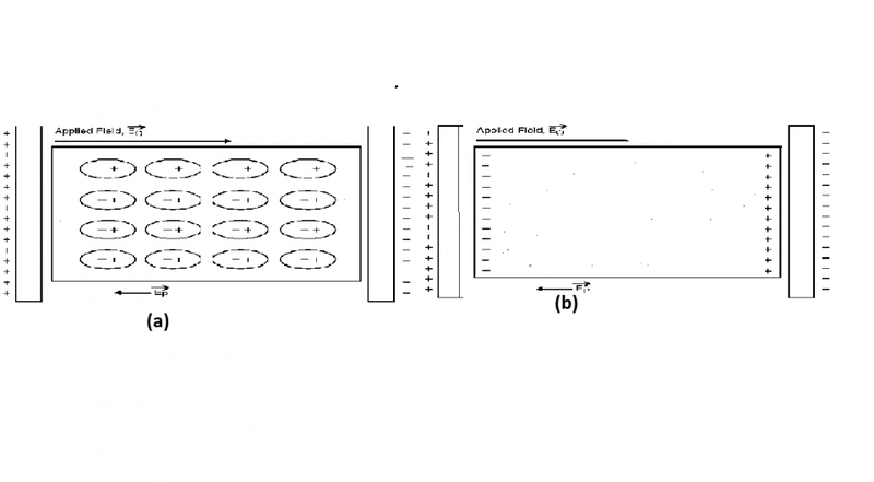

A dielectric is placed between two capacitors ,How (a) gets transformed into (b)
Where did all the dipoles present in picture (a)go?And from where the negative and positive charges appeared inside the dielectric in picture (b)
The + and - poles in the middle region will cancel each other. That will leave +ve polarity near -vely charged plate and -ve polarity near the +vely charged plate. Its a rearrangement of the charges inside the dielectric. I believe its called dipole polarization.

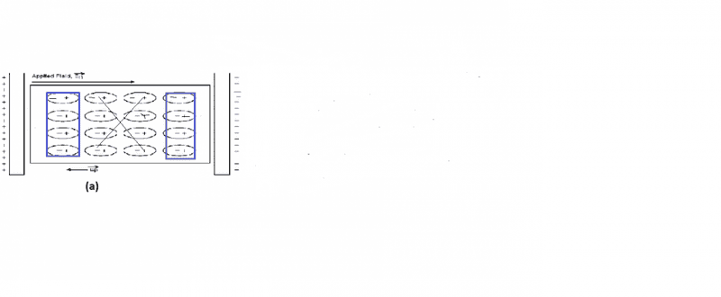

Then these dipoles should remain which I have shown in blue box.
Their poles near the walls cause the electric field inside the dielectric.

I still don't understand.
Consider left blue column. Its +ve poles will nullify the effect of the -ve poles of the next column. This will go on till the last column(rightmost blue). The +ve poles of the last column and -ve poles of the first (leftmost blue) column will create the electric field inside the dielectric which will be opposite to the one created by the plates.
Got it!Thanks
I'm not sure if "nullify" is the proper word here. I believe it should be "attract".This structure forms a resultant single large dipole that opposes the field due to the plates. Think of the dipoles as batteries connected in series. Their voltages will add and across the two far ends, this total voltage will be available. Similarly, the fields of the dipoles will add and the resultant field will be available inside the dielectric ,opposite to that of the plates.
It is just showing that the dielectric material has no bulk volumetric charge density, but does have a surface charge density.
