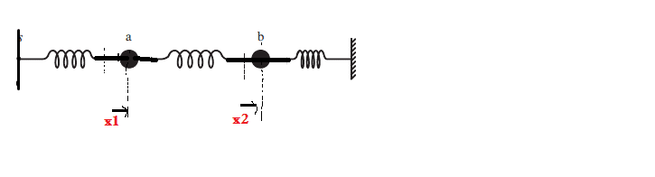

How do you determine the forces in a coupled oscillating systems? (check the attachment for coupled oscillating system)
I do get the forces right but I make mistakes with the signs.

i can only suggest that you draw a very clear diagram, carefully labelling the distances, and then write out a constraint equation such as a + b + c = L :wink:
(do you want to show us an example of your going wrong?)

Consider the 2nd diagram in the attachment and assume that it is attached on both ends and that x1 is extension in a and x2 is extension b.
for mass a:
-k (x1)
k(x1-x2) <--- now i am not sure whether to put a negative sign with it or positive
for mass b:
-k (x2)
k(x2-x1) <--- again i do not know what sign to put here.

call the points O A B C, with OC = L
how long are OA AB and BC ?​
We haven't been specific about the length in class but let's assume that L/3 = oa= ab= bc
but A and B are moving :confused:
It is a screen shot at a time when the springs are stretched. I just need to understand which direction the forces apply.
