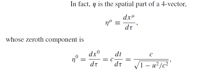

I agree. The spatial part of the 4-velocity vector is:
$$\eta^µ = \frac{dx^µ}{d\tau}$$
Where ##x^µ## is the displacement 4-vector.
\eta^\mu = \frac{dx^\mu}{d\tau}
Where ##x^\mu## is the displacement 4-vector.
This isn't the "spatial part" of the 4-velocity vector, it is the 4-velocity vector. ##x^\mu## is all four coordinates, including the time coordinate ##t##.
I see what you mean. Then technically ##\eta## is the spatial part and ##\eta^0## the time part.
Source: Introduction to Electrodynamics by D. Griffiths.
By the way, note that in post #7 I meant the derivative of the proper velocity 4-vector.
PeterDonis said:
Proper acceleration is the derivative of 4-velocity with respect to proper time. "Proper velocity" refers to something different.
So I do not see the difference between proper velocity 4-vector and 4-velocity vector.
I guess you assumed proper velocity not to be a four vector.
I would not use Griffith's as a main reference for SR. In normal SR jargon, nobody uses "proper velocity 4-vector" - just "4-velocity". "Proper velocity" is something different, see the Wikipedia link Peter provided - it is the spatial part of the 4-velocity.
As you will see if you look at the link I gave for proper velocity, that term usually means the spatial part of the 4-velocity vector. Griffiths uses "proper velocity" to mean the entire 4-velocity vector, but that usage is not very common.
