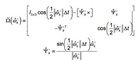

Thanks for clarifying the second question. I have seen some literature mention numerical integration for propagation, which I assumed to be the q=q+qdot*dt along with kinematics equation. I have also came across a paper which propagate using:
where
Are the essentially the same? The second equation seems to normalize the propagated quaternion.

With regard to [itex]\hat{\boldsymbol q}^-_{k+1} = \bar{\Omega}\bigl(\hat{\omega}^+_k\bigr) \hat{\boldsymbol q}^+_k[/itex], pre-multiplying by that matrix is identical to post-multiplying by the quaternion [itex][\sin\frac{\omega \Delta t} 2 \boldsymbol e_{\omega}, \cos\frac{\omega \Delta t} 2][/itex] where [itex]\omega=||\hat{\omega}^+_k||,\ \boldsymbol e_{\omega} = \hat{\omega}^+_k / ||\hat{\omega}^+_k||[/itex]. That quaternion in turn is the quaternion exponential of the pure imaginary quaternion [itex][\frac{\hat{\omega}^+_k \Delta 2}2, 0][/itex].
So where does this come from? A translation vector [itex]\boldsymbol x \in \mathbb R^3[/itex] with a constant velocity [itex]\boldsymbol v[/itex] updates via [itex]\boldsymbol x(t+\Delta t) = \boldsymbol x(t) + \boldsymbol v\Delta t[/itex]. That is what justifies the additive form you typically use for integrating position.
This is not true for orientation. Suppose an object is rotating at a constant angular velocity. If you represent orientation as a right transformation quaternion (which is what you are apparently using), the equation of motion for that object rotating at a constant rate is [itex]\boldsymbol q(t+\Delta t) = \boldsymbol q(t)\exp\bigl(\frac{\omega \Delta 2}2\bigr)[/itex]. The reason you can use the naive [itex]\boldsymbol q(t+\Delta t) = \boldsymbol q(t) + \dot{\boldsymbol q}(t)\Delta t[/itex] is because of the small angle approximation.
