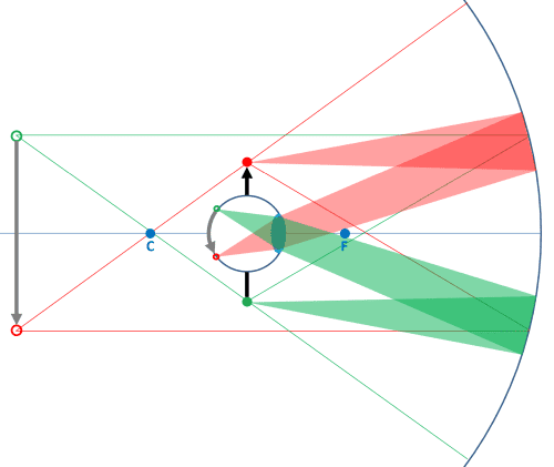

He is asking about the case where the object is between the curvature center and the focus:
Here you have a true image behind the object. But for what you see, only the true image on your retina matters.
Looking at that diagram again: Since the real image on the retina is flipped, you should see yourself not flipped in this case. Assuming your eye can still focus these rays.
So the distance at which the image on your retina flips, is not the focus point but the center of curvature. The focus point is merely the distance at which the not flipped virtual image behind the mirror is replaced by a real image behind you.

Thankyou A.T. From this diagram I understood that-
The Light Rays from the Man hit the concave mirror,Reflect back and converge in the retina itself due to which the Real image is formed in the Retina and The eyes assume it to be coming from behind the mirror due to which the person see his inverted and real image in the concave mirror...
Am I Correct Now...?

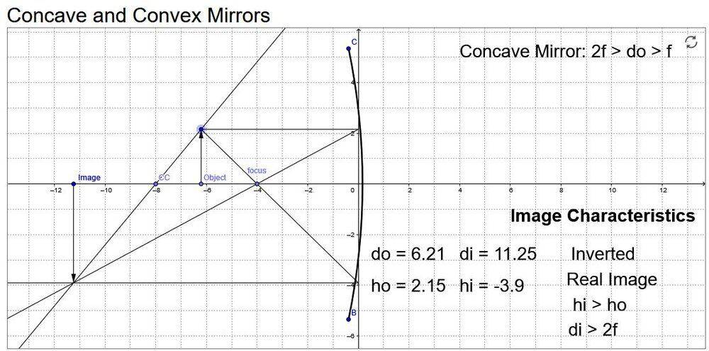

I still don't understand this. How was the last picture captured? Was there a screen in the guy's head to capture what his eyes see? It looks like this was an image capture elsewhere of him!
This is the ray diagram which you should have drawn for this situation.
But here's the problem. A human eye cannot focus on converging rays. The person, being the object, will see converging light rays entering his eyes. Unless he wears corrective glasses to compensate for that, he won't see a focused image.
There will, however, be a focused image at the location shown, but this can only be seen on a screen.
The only way for an eye to see a focused imaged is if this is observed at a distance LARGER than where the focused image is. Stand far back enough, and you will start to be able to see a focused image of that person with your eyes. That is why I questioned how that second picture was taken! It certainly wasn't taken by that person in the picture, because I noticed no camera.
Zz.

So the seen image will get blurry, when you get past the focus point.
But you still should be able to see if it is flipped or not. And based on post #35 it seems like the seen image is not flipped, when you are between focus point and center of curvature.
  • #45
A.T. said:
So where did I go wrong in post #35?
I don't think you went wrong; I did, forgetting that an inverted image on the retina is interpreted as erect by the brain.

hutchphd said:
The camera is focused on that image plane. If you put a screen at the image plane the picture in the camera would be unchanged (of course you couldn't interfere with the object...this is easier with a lens!)
If you put a screen farther than where the focused image is, you will not get a focused image.
If you try to view the image with your eyes at a distance father than the location of the focused image, you will see the object.
If you try to view the image at a distance smaller than where the focused image location is, you will not see a focused image with your eyes.
Is there anything contradictory to what you just said here?
Zz.
  • #58
Nope. I think I said the screen needs to be put in the image plane (which is determined by object distance). So we are copacetic...hope the OP is.
