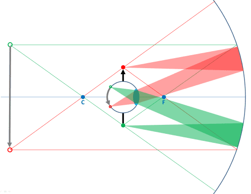

  • #122
Sophiecentuar I just wanted to confirm that by saying r you mean the radius of curvature of the concave mirror...?
  • #123
Thanks to @sophiecentaur and @A.T. My insistence that the entirety of the imaging lens needed a negative focal length in the "interim" region was not correct. For a fixed focus camera/eyeball only a corrective lens would need to be negative. Apologies for the oops. I think we agree.
If I can find a suitable mirror I may make a movie...I have a decent optical rail ...YOUTUBE watch out.

  • #127
A.T. said:
- For a distant camera the picture inversion happens when the object is at the mirror's focal point.
- For a camera at the object the picture inversion happens when the camera & object are at the mirror's center of curvature.
Just for completeness the remaining case:
- For a distant object the picture inversion happens when the camera is at the mirror's focal point.
  • #128

  • #132
A.T. said:
An object is mirrored if an odd number of dimensions is inverted.
- Normal flat mirror inverts 1 : back&front -> you see a mirrored object
- Non-reversing-mirror inverts 2 : back&front, left&right (e.g.) -> you see a non-mirrored object
- Concave mirror with object & eye within radius of curvature: inverts 1 : back&front -> you see a mirrored object
- Concave mirror with object & eye beyond radius of curvature: inverts 3 : back&front, left&right, up&down -> you see a mirrored object

  • #133
SecularSanity said:
Let me see if I understand you correctly. When the image is anywhere...
I didn't say anything about the location of "the image", just about the location of object & eye, and what the eye sees. Basically watching your own face in the mirror.
One reason why this thread is so long, is talking about "the image" in a scenario with multiple images.

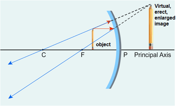

sophiecentaur said:

  • #150
SHASHWAT PRATAP SING said:
Sir I thnk you didn't understand my question-
Imagine a situation where we have a concave mirror of large size and we ourself is object and we are directly seeing in the concave mirror and moving backwards so when I stand between focus and pole I see my virtual image slowly when I move backward between focus and centre of curvature then my image must be forming behind me then how my eyes are able to see my real image in the mirror….
Sir to image the real image my eyes must see the image first but in this case how without seeing the image my eyes can see the real image in the mirror it self HOW IS IT HAPPENING …..
THE PHOTO WAS JUST AN EXAMPLE...
SIR IN MY QUESTION JUST I MYSELF IS VIEWING ME IN THE CONCAVE MIRROR AND MOVIENG BACKWARD
SO WHEN I COME BETWEEN FOCUS AND CENTER OF CURVATURE MY REAL IMAGE WILL BE FORMED BEHIND MYSEF BUT HOW STILL I AM ABLE TO SEE MYSELF IN THE CONCAVE MIRROR HOW?
MY REAL IMAGE MUST BE FLOATING IN AIR BEHIND ME BUT STILL MY EYES ARE ABLE TO SEE IT IN THE MIRROR...HOW
I too have the same question but not getting an answer...
I was actually asking that
Why can we see our inverted image inside a concave mirror when the image is formed in front of it the mirror and not behind?
