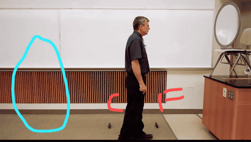

I am saying that if the camera were in the man's eye socket we would not see an image for the part of the trip between cc and focal point. There will be an image formed that is inaccessable to camera view.

You have provided a number of pictures. Let us go through them slowly. Let us identify carefully what they show.
The first picture is of someone standing nose to mirror. There are two locations marked on the floor. One is marked "C". One assumes that this is at the center of curvature of the concave mirror. The other is marked "F". One assumes that this is at the focal length of the concave mirror.
This impression is reinforced by the fact that the distance from the mirror to C is approximately double the distance from the mirror to F.
But you are not asking about the situation in the first picture. So that picture is mostly wasted.The second picture is of someone standing between the focal point F and the center of curvature C. We see a blue shape drawn in space behind the person. One assumes that this is the place where the [inverted] real image of the person would form.
The person stands in the way of some of the reflected light that might otherwise go into forming this real image. As a result, the real image may not be viewable from all angles. However, this detail is irrelevant to the question that we are trying to address. Let us ignore that situation and proceed.The third picture is the same as the first but without the "C" and "F" labels drawn in. We can ignore it.The fourth picture is the same as the second. But instead of "C" and "F" labels and an image drawn behind the person, we have an arrow in front of him pointing toward the mirror.
This would appear to be an attempt to depict the person's line of sight toward the mirror.The final picture appears to have been taken from a little to one side as the man stands in the position depicted in the second and fourth pictures. That is, it was taken while the man is standing between the C and the F. It shows an inverted image.
This appears to be an attempt to show what the person himself sees. I may be mistaken, but that might be the camera's reflection in the person's right hand.If I understand your concern, it is that if we are looking away from a real image, we might not expect to be able to see that image. Certainly, our intuitive expectations learned from everyday life tend to support this. If person is standing behind me, I cannot see them when I am looking toward the front. If an image exists behind me, I might not expect to see it when I am looking toward the front.
This expectation is incorrect. The photographic evidence you have provided demonstrates that it is incorrect.

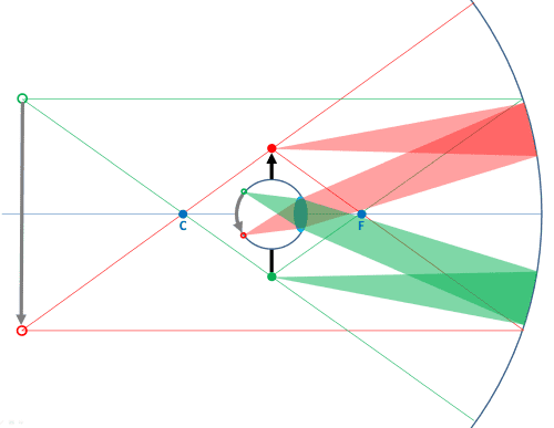

The light rays that hit your eyes are light rays that would have converged at the real image behind your head. But they did not converge there. Your eyes were in the way. The lens in your eyes (or in your camera) caused them to converge on your retina (or on the photodetector array in your camera) instead.
You "see" the image because the pattern of illumination on the retina (or on the photodetector array) corresponds to the shape of the person.
Human eyes are not designed to be able to clearly image converging light rays. It requires that they relax to a focal length longer than the distance from lens to retina. A focal length equal to the retinal distance would allow one to clearly focus on objects "at infinity". A shorter focal length allows one to focus on objects closer in. A longer focal length allows one to focus on images corresponding to convergent light rays -- that is real images behind the head.
There is no evolutionary call for eyeball lenses that can focus out past infinity. And little technical call for cell phone lenses that can do the same. The cell phone image of the reflected inverted man is not sharp. But with a narrow aperture, one can push the limits.

  • #69

After thinking further, the fact that you see an inverted image is relevant and indicates that the person is not actually positioned between the center of curvature (C) and the focal point (F).
If the person were positioned between C and F the resulting image would be real, would be positioned on the far side of the C and would be inverted. Rays coming from the person's head would arrive at the bottom of the image. Importantly, this means that they would arrive at a downward angle. Rays coming from the person's feet would arrive at the top of the image. Importantly, this means that they would arrive at an upward angle.
But your eyes are in the way. They intercept these rays. Instead of an inverted real image forming in space to the left of the C, these rays would form an inverted real image on your retina. The rays from the person's feet would arrive at an upward angle and would illuminate the top of the retina. The rays from the person's head would arrive at a downward angle and would illuminate the bottom of the retina.
But an inverted real image on your retina is what you get when looking at an ordinary upright person. If the scenario were actually as you describe, the image you perceived and the image that your camera perceived would have both have appeared to be upright.
Accordingly, I must retract my earlier analysis and conclude that you are actually standing to the left of the C and that the real image is in front of you.

Looking at that diagram again: Since the real image on the retina is flipped, you should see yourself not flipped in this case. Assuming your eye can still focus these rays.
So the distance at which the image on your retina flips, is not the focus point but the center of curvature. The focus point is merely the distance at which the not flipped virtual image behind the mirror is replaced by a real image behind you.

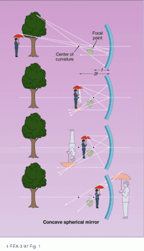

Why can we see our inverted and real image inside a concave mirror when the image is formed in front of it and not behind?
If you say that our eyes tries to image the real image formed by mirror on the mirror itself then-
Imagine a situation where we have a concave mirror of large size and we ourself is object and we are directly seeing in the concave mirror and moving backwards so when I stand between focus and pole I see my virtual image slowly when I move backward between focus and centre of curvature then my image must be forming behind me then how my eyes are able to see my real image in the mirror….
Sir to image the real image my eyes must see the image first but in this case how without seeing the image my eyes can see the real image in the mirror it self HOW IS IT HAPPENING …..
Consider this video on youtube -https://youtu.be/7zv-4Zh-9R4
Please answer me in detail... sir i am eagerly waiting for answersView attachment 265660
A real image is seen when the light rays themselves actually converge. A virtual image is seen only where the light rays appear to converge. In other words, a virtual image is made when our eyes trace the rays back behind a mirror or lens. When you’re close to the concave mirror, between the focal point and the mirror, it’s a virtual image. The image will be upright and magnified. A real image is inverted and a virtual image is upright.
Your diagram is what’s confusing you. They’re not indicating that the image is formed behind you. They’re showing you the linear (sometimes called lateral or transverse) magnification equation.
