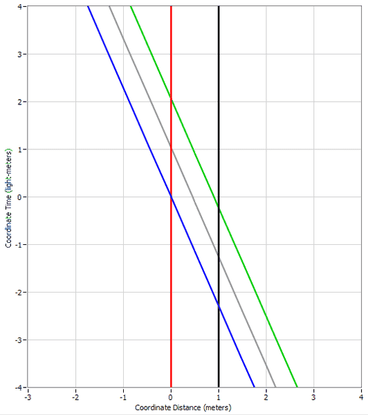

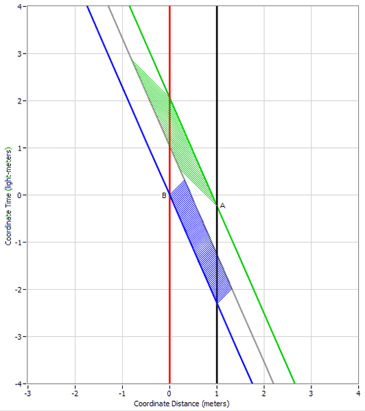

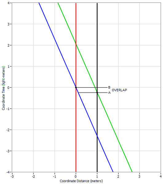

Then how do you explain what I already asked you to look at in post #22?
Look at this diagram showing the rest frame of the apparatus. I have drawn in two black lines to show the gap between them where there is no simultaneity between the black and red receivers detecting the meter stick (between the blue and green worldlines).
Spacetime diagram in the rest frame of the apparatus: coordinate time in light-meters against coordinate distance in meters, with blue and green vertical worldlines at 0 and 1, red and black tilted worldlines, and a horizontal GAP marked between two black lines.
Now here is the same scenario transformed to the frame in which the meter stick is at rest. I have drawn in two black lines to show the overlap where there is simultaneity between the black and red receivers detecting the meter stick.
Spacetime diagram with coordinate distance in meters on the x-axis and coordinate time in light-meters on the y-axis, showing a red vertical line at 0, a black vertical line at 1, and blue and green diagonal worldlines, with an OVERLAP region marked near time 0.
If you still disagree, then I would ask you for a reputable reference that states that the lighting of a lamp is frame variant.

The OP specified all the values of your variables:
L = 1 (meter)
1/γ = 0.9
Therefore:
γ = 1.11111
v = 0.43589c
Your two events are x=0, t=0 and x=1, t=0 and here is my previously drawn spacetime diagram with those two events marked as black dots:
Spacetime diagram with coordinate distance in meters on the horizontal axis and coordinate time in light-meters on the vertical axis; a blue vertical line at x=0, a green vertical line at x=1, a red line and a black line slanted through the origin region, with black dots at (0,0) and (1,0).

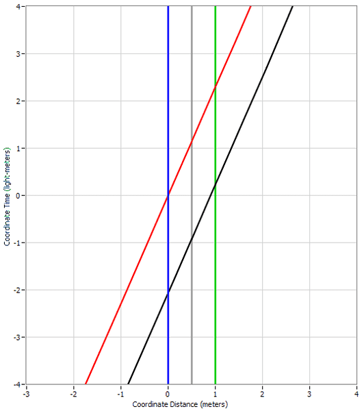

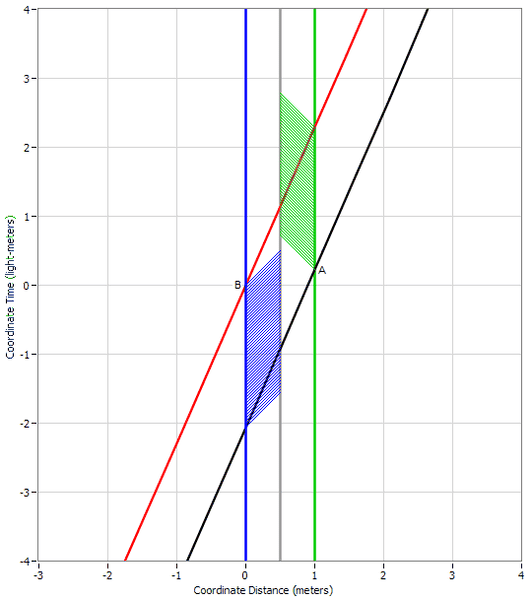

Orodruin said:
Those events transform to the stick rest frame by Lorentz transformation to
Δt' = -vγΔx = -vγL
This evaluates to:
Δt' = -vγL = -0.43589 * 1.111111 * 1 = -0.48432
However, you didn't do the calculation for Δx' which evaluates to 1.111111.
So here is the diagram transformed to the stick rest frame with the same two events marked as black dots:
Spacetime diagram with coordinate distance in meters on the horizontal axis and coordinate time in light-meters on the vertical axis; a red vertical line at x=0, a black vertical line at x=1, a blue diagonal line through the origin and a green diagonal line through x=1 at t=0, with black dots at (0,0) and (1,-0.5).
Orodruin said:
It follows that the statement of having the receivers covered simultaneously in their rest frame is equivalent to the statement that they are covered with a time difference -vγL in the stick rest frame. Thus the lamp will turn on if the furthest receiver is covered at t' = t0' - vγL and the closest at t' = t0'. Now obviously L is measured in the receiver rest frame, but this can easily be swapped for an expression in the stick rest frame by Lorentz contraction.
I still have no idea how transforming those two events determines a time difference that has any bearing on the subject. Maybe you could copy the spacetime diagram and mark it up to show what you are saying or at least provide specific details that will help explain what you are concluding. You need to explain what t0' is and which receiver is the furthest one (what color in my diagram). Also, I don't know why you made the comment about L in your last sentence.
