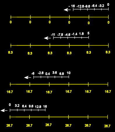

Freixas said:
@PeterDonis: I like to work things out fully for myself, which takes time. I understand things better when I can crank through all the logic on my own.
I thought I had found an error in my work. This just told me my conclusions were wrong, but it didn't provide a solid understanding of why. Thus, I revisited the thread and re-read a number of your posts.
I realized I still didn't understand how BN could read A's clock as 1.8. Tracing through your comments, I think the problem starts here:
If I take this approach, I arrive at a logical contradiction. So I clearly still don't understand.
Let's look at things from A's frame only. Let's remove the infinite line of closely spaced B's and replace it with a line of B's that are spaced evenly 4 LY apart as measured by A. Traveling at 0.8c, A will expect to see a B pass by every 5 years. The math seems simple and unavoidable. Each time a B passes by and sees A, it should see that A's time is a multiple of 5 (if the first conjunction occurred at 0). I can't picture any other scenario that makes sense. We're are looking at things from A's view, but the event (and A's clock reading) is in all frames.
I'm not looking at things from B's frame at all. It shouldn't matter. A's viewpoint provides all the information I need. We don't care about B's clock anywhere, just about what A's clock says at conjunctions.
You tell me that the first trailing B (what you call BN) will see A's clock as reading 1.8 years at conjunction. I can't see how. Help!
This is really the heart of my objection. What follows is just details.

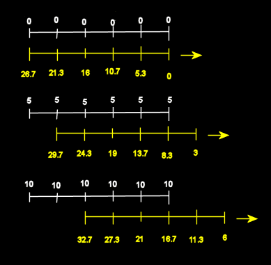

Let me draw the clocks based on your statement about clock synchronization. I am going to add a line of A's, also spaced 4 LY apart as measured by A.
A . . . . A . . . . A . . . . A . . . . A
B . . . . B . . . . B . . . . B . . . . B
^-7.2 . .-5.4 . . .-3.6 . . .-1.8 . . . 0
^-5.4 . . .-3.6 . . .-1.8 . . . 0
^-1.8 . . . 0
^0
The caret points to the corresponding B's view of each of A's clocks at B's time 0. The time listed under each A, is the time as perceived by the B with the caret. As I imagine movement in typical Western left-to-right fashion, the rightmost A is the one that we've been concerned with. The rightmost B is the "lead B" or B1. All times are for when the lead B is at time 0, so all B's perceive the lead A to have time 0. This is my interpretation of your statement.
The other times are what I think they would be so that B would perceive A's clocks advancing by 1.8 years as one B went to the next. If we advance this diagram by 3 years (B's time) or 5 years (A's time), the trailing B would say that the lead A's clock reads 1.8, which I believe to be impossible.
Here's the way I think things should like so that B sees a multiple of 5 at each conjunction. B also sees A's clocks advancing by 1.8 years during the trip:
^0 . . . 3.2 . . . 7.4 . . . 9.6 . . . 12.8
^0 . . . 3.2
^0
In this example, the last B would reach A (the lead A) in 4 * 3 = 12 B years (4 * 1.8 = 7.2 years A years from B's view) and A's clock would read 7.2 + 12.8 = 20.
In my diagram, when B's clocks are at time 0, each adjacent A's clock also reads 0. But the lead A's clock reads 0 only for the lead B.
I have no idea if this diagram is a representation of how things work. All I can say is that it satisfies these two constraints: A's clocks are a multiple of 5 at conjunctions and B's perceive A's clock as running at 0.6x (assuming I did the math right, always a concern).
Events according to A's clocks (white)
Events according to B's clocks (yellow)

I think a key issue you have not realized is that there are three different things you could specify, and they are not independent:
(1) You could specify the spacing of the B clocks in the A frame;
(2) You could specify the reading on the B clock "adjacent" to B1 when it passes clock A;
(3) You could specify the reading that the B clock "adjacent" to B1 sees on clock A when it passes it.
Once you have specified anyone of these three things, the other two are fixed. At different points in this thread, you have specified all three of these: 4 LY for (1), 3 years for (2), and 5 years for (3). It turns out that 4 LY for (1) and 5 years for (3) specify the same scenario (the same set of values for all three things); but 3 years for (2) does not. So you have specified at least two different and mutually inconsistent scenarios in this thread, and have not kept track of which one you are talking about, so you are mixing numbers from the two, which of course is going to confuse you.
Just to quickly summarize the two sets of values: the "clock BN" scenario specifies 3 years for (2); and the other two values fixed by this specification are 1.44 LY for (1) and 1.8 years for (3).
The "clock BA" scenario specifies 4 LY for (1); and the other two values fixed by this specification are 8 1/3 years for (2) and 5 years for (3). (At other points you have specified 5 years for (3), which gives the same scenario.)
Note also the relationships between the three numbers. The number for (1) will be ##v## times the number for (3); and the number for (2) will be ##\gamma## times the number for (3). That is the simplest way to calculate the other two numbers from anyone of them.

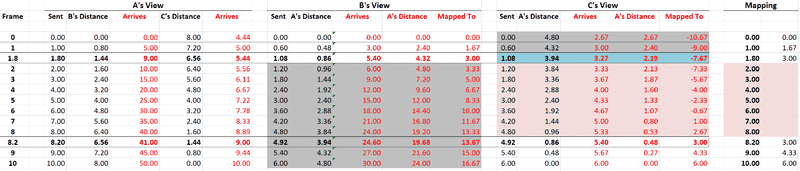

Long ago I proposed a thought experiment about creating a light-delay-corrected video so as to "see" the twins paradox in play.
To review: In A's inertial rest frame. B and C move away and toward him, respectively, both at 0.8c. When A and B meet, they synchronize their clocks at 0. A begins transmitting a video of his clock to B. B records the video. B eventually reaches M, a location 4 LY from A in A's frame and at rest relative to A. Here, B encounters C and gives C the video recorded thus far. C synchronizes his clock to B's, which now reads 3 years. C continues recording video from A. When C arrives at A, he transfers the video to A, who will attempt to construct a new video, with each video frame corrected for light delay as per B's or C's frame.
I'm going to simplify this a bit. B will continue recording video until a frame get mapped to 3 years. He won't be able to do this until he is long past M. He will ship his video back to A by interstellar post. A will assemble the video so the first 3 years come from B's footage and the last 3 from C's. Keep in mind that the frames represent where B (or C) was when they believe A sent a frame, so the 3 year mark of the mapped video is when B and C met at M.
Some people may not realize that video contains timecodes. In this case, the timecodes begin at 0 when B's clock is 0, and continue tracking local time. Anyone looking at the video later will have both the content of the video and the local clock reading when video was received. And yes, I realize each individual frame will need to be corrected for the relative Doppler shift in order to be viewable. We consider a video frame to arrive at the moment the first pixel is received.
My (self-imposed) assignment was to do the calculations for this scenario. Setting up the problem and working through all the equations was a learning experience for me. The video generated may not mean a thing, but the exercise was interesting and worthwhile. The simplification I used is not needed. Knowing all the parameters of the setup and when C receives frames sent on B's leg of the trip, one could calculate where B was when that frame was sent. When I say "one could", I don't include myself.
The video would be equivalent to that produced by a single traveler making an instantaneous turn-around--the infamous twins paradox. Since that is not possible, I think one could create an equivalent video where acceleration is used to turn around at M. Again, "one could" is even farther from being me, and I believe the calculations become a lot more difficult.
I have attached a spreadsheet showing my calculations. The spreadsheet contains two sheets: one labeled "Setup", which should be self-explanatory and another labeled "Simulation", which needs some explaining. Let me add a screen shot:
The first column shows the frames sent. To simplify further, I just calculated frames at 1 year intervals, with the exception of frames at years 1.8 and 8.2.
I've created sections for A's view, B's view, and C's view. The numbers in black represent things related to when a frame as sent. The numbers in red represent things related to when the frame was received (OK, technically, the mapped column shouldn't be red). For B, we ignore everything after we get a frame that maps to B's year 3, so these have a gray background.
C's view is a little cluttered. Gray represents frames that map to a position earlier than 3 years. However, the blue-green row is a frame that C receives and that B didn't (not until after M). We could use a different mapping to allow this frame to fill in the rest of B's leg of the trip (but I haven't). The following lines have a pink crosshatch. These are frames that don't map either to B's 3 year trip from A to M or C's 3 -year trip from M to A. They are tossed away.
The final column shows the mapped video. At the 3-year mark, we see A's 1.8 year frame. At the 3-year mark, we also see A's 8.2 frame. You can pick one or the other or blend them. However, you always see A's clock running slower, at at 0.6 rate to the video timecodes.
Three frames are highlighted by a box around their row. Frame 1 was the frame received when B and C were at M. Frames 1.8 and 8.2 are the frames that were sent when B and C were at M (one from B's view and one from C's view, of course).
This may be a trivial exercise for an experienced physicist or mathematician. The last time I attended a math class was before 1976, so I'm a little rusty. Plus I appear to have some sort of arithmetic dyslexia :wink:. Using a spreadsheet keeps me honest.
