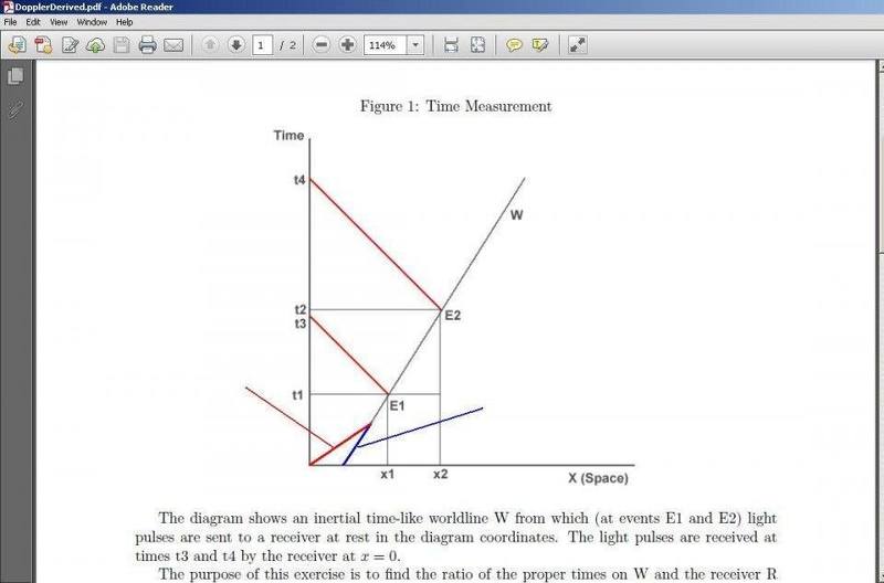

This Doppler stuff is a bit tricky so I've attached some of my old notes (tidied up) where I worked out the Doppler equation from a ST diagram. It turns out to be just algebra and a bit of simple geometry. This calculation has not been checked but it works out so neatly I'm pretty confident it's right.

  • #32
That's correct. You use period instead of frequency, but it is all correct.

  • #34
First, before I study it. I want to ask something.
I try to continue your worldline in the past (blue line) it touches the bottom of x axis, not at coordinate (0,0) as indicated by the red line. I add the line myself.
##{\tau_E}^2 = (t2-t1)^2 - (x2 - x 1)^2 (1)
= (t2 - t1)^2 - (vt2 - vt1)^2 (2)##
So, x2 = vt2 and x1 = vt1.
Shouldn't the wordline originate from (0,0)? It's not that I like to criticize, I'm afraid I miss something here. But if you just draw it not to scale, but to make better understanding, then, it's all right with me.
  • #35
The worldline (W) can be anywhere. I did not mark it but the bottom left corner is (0,0) as you deduced.
The calculation does not depend on the values of ##x_1## nor ##x_2## as long as they are not equal.
The calculation is correct so you have misunderstood something.

  • #37
Stephanus said:
I didn't say the calculation is incorrect. It's the picture that I asked.
Shouldn't world line originate from (0,0). From your picture it originates not from (0,0)
OK...
A worldline can originate at any event and continue to infinity if you like. W can be extended into the future or past but I have only shown the epoch where the signals are sent.
You must remember that the things are moving only in the +x or -x direction. The worldline describes motion in the x-axis - it is a path through spacetime, not space. If you want to see things moving try the 'Animate' feature'
  • #38
Thanks.
So this formula is not for blue shifted/red shifted. It's for (proper time for rest)/(proper time for w)
  • #39
Stephanus said:
Thanks.
##\tau_R/\tau_E## is the Doppler shift. In this case it is a red-shift because the period is increasing and the frequency is decreasing.
Suppose the sender sends 100 pulses with 1 second ( by his clock) between them. Then they would be received with gaps of ##\sqrt{(1+v)/(1-v)}##secs on the rest clock so the frequency is lower by the inverse of that.
  • #40
