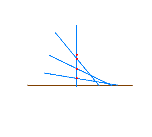

A rod initially held vertically is falling on a frictionless surface when given a slight push.I just want to how the rod would move.I am thinking that the rod as a whole will move forward and also rotate about the point on the ground.
Why the rod is moving forward?(if you ask me)
I think that the CM is going in circular motion and thus will experience an outward pull. This force will take the rod forward.
But i have heard that the rod purely rotates and does not move forward as a whole.

If the surface is frictionless ,as in the picture,the lower end slips on the surface towards right ,in a manner such that the CM of the rod moves vertically downwards .You can consider the motion of the rod as a combination of translation of CM + Rotation around the CM.
I have made a rough sketch .The red dot shows the CM.

For the end to slip should there be any net force acting on it?
I got it
thanks a lot:smile:
