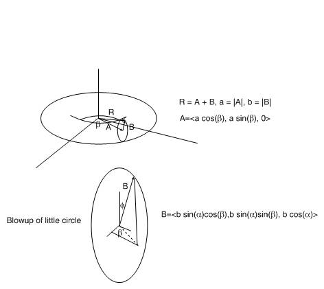

Oh, okay. It just seems like if you had donut floating in space that if defined by some parametrization x(∂,ß), y(∂,ß), z(∂,ß), values of ∂,ß would map to a point on the surface. Like I know if you have x(t), y(t), you can regions in the x-y plane into cool things like cartoids, that could not be made with just x, y=f(x). I'm just confused about how exactly the equation for the radius of a sphere in x-y-z space gets turned into the a formula for the distance between the origin and the center of a donut. :confused:
Here's a picture that may help you understand the parameterization:
Edit: The φ in the picture should be α or vice - versa. Too much trouble to change it now
