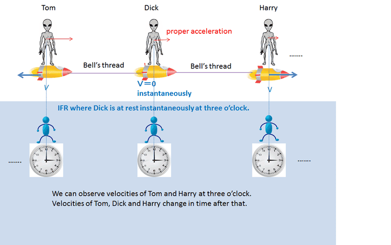

In an inertial frame of reference let numerous standard rockets that load synchronized standard clocks place on all the space lattice. Simultaneously the rockets start to move with same intrinsic acceleration to the same direction. In other words there exists a common instantaneous inertial frame of reference to all the rockets.
May I understand it as a description of uniformly accelerating frame of reference ?  If so I worry Rindler coordinates cover only part of the frame of reference. Is it OK?
No, there does not. The clocks will not generally keep being synchronised and the space ships will have different velocities in the instantaneous rest frame of any of them. I suggest looking up and trying to understand Bell's spaceship paradox.

Thanks all for advice. Let me summarize my understanding here.
In an inertial frame of reference(IFR) let numerous standard space ships that load synchronized standard clocks place on all the space lattice, labelled with the coordinates. Simultaneously the ships start to move with same proper acceleration to the same direction.
a. There always is an instataneous IFR where all the ships are at rest.
b. In the instataneous IFR the distances between the ships in that direscion increase.
c. In the instataneous IFR the clocks are not syncronized in that direction. Faster forward, delayed backward in proportion to distance.
No. This is not correct. See posts 5, 7, and 8.

Let me clarify the situation (hopefullly) by pointing out that there are two different notions of a line of rockets accelerating together, and they're not the same in Special Relativity (although they are the same in Newtonian physics):
  1. The line of rockets start off at rest in some rest frame, and then they all accelerate with the same acceleration profile (that is, they all accelerate such that they all "feel" the same g-forces).
  2. The line of rockets start off at rest in some frame, and then they all accelerate in such a way that the distance between the rockets remain constant--as viewed by the travelers on board the rockets.
These aren't the same thing. If the rockets all have the same acceleration profile, then
  • According to observers in the original rest frame, the distance between the rockets remains constant.
  • According to observers on board the rockets, the distance between the rockets steadily increases.
If the rockets keep the same distance apart (which is called "Born-rigid acceleration"), then
  • According to observers in the original rest frame, the distance between the rockets shrinks with time.
  • According to observers on board the rockets, the distance between rockets remains constant.
In the case of Born-rigid acceleration, the rockets do NOT have the same acceleration profile: the rockets in the rear have a larger acceleration (and feel greater g-forces) than the rockets in the front.

Second try:
If you pick one specific observer from the congruence of observers, at any instant of time that observer has an instantaneously co-moving inertial reference frame, henceforth abbreviated as ICMIRF specific to that observer at that instant of time. Establishing that all the other observers in the congruence share the same instantaneously co-moving frame is something that needs to be determined. In general it's not true. The only way I know of checking this involves a fair amount of fairly advanced math. You represent an inertial reference frame by its basis vectors, ##\hat{e_x}, \hat{e_y}, \hat{e_z}##. To compare inertial reference frames, you need the concept of the connection coefficients and parallel transport. Given a metric, you can compute the connection coefficients and determine if it's true that the basis vectors in the second frame (which we will indicate by a prime symbol) are the same as the basis vectors in the original frame - i.e. that ##\hat{e'_x}=\hat{e_x}, \hat{e'_y}=\hat{e_y}, \hat{e'_z}=\hat{e_z}##. Fortunately, in the context of special relativity, parallel transport is path independent, so the notion of comparison of the basis vectors is well defined and path independent.
Some counterexamples of frames where the ICMIRF's are not shared are rigid rotating frames, where every point in the rigid rotating frame has a different ICMIRF, and expanding frames, such as the "Bell Spaceship" frame .
Thanks perverct. So I try to correct. In uniformly accelerating system the following applies again,
sweet springs said:
a(revised). There always is an instantaneous IFR where ships on a traverse line are at rest and others have different speeds in that direction. Faster forward, backward faster backward in proportion to distance.
where not "in proportion to distance" but in a subtle way so that the Bell's threads are not broken.
It is interesting that the speed of the both ends of thread are different in the ICMIFRs but the threads are not torn apart. The speed of the bottom line of the ships reach light speed.
