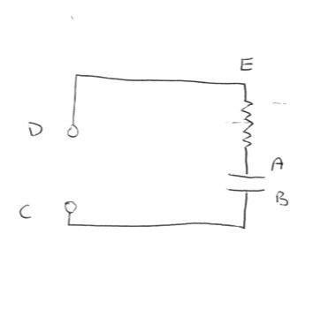

  • #61
IssacBinary said:
No not really. If I get my lagging and leading mixed up it wouldn't really matter too much (some say it does)
Not mixed up.
If your explanation predicts a lagging current, but the real current is actually leading, then your explanation has a huge flaw.
In physics-speak: your explanation is disproved by simple experiment.
IssacBinary said:
The phase shifted current isn't coming out of thin air, its being created by a voltage that is in phase with it, but its a "resultant" voltage because its made up of different "happenings" in the circuit. So my guess why its never explained this way is because this "resultant" voltage is neither the source voltage or voltage across the capacitor.
Ah, that's the sticking point.
The phase-shifted current *is* coming out of thin air.
It's not being created by a voltage that is in phase with it.
This "resultant" voltage isn't in the circuit. It's not part of the intuitive/picture/verbal description.
It doesn't exist.
Let's get down to details. Why do you see a need for the "resultant" voltage? Is it because voltage causes current?

IssacBinary said:
What is the mechanics that's causing the current at any point in the circuit to be out of phase with the source current.
This thread is too long for me to read through before midnight, but I hope someone has sorted you out on what I've quoted.
If for simplicity we consider a series circuit, then the current through every element is equal and exactly in phase with the current drawn from the power source. It's a series circuit, so the current at any moment in time is identical in every element. There is no phase shift in current anywhere in a series circuit.
In a series circuit, isource(t) = iR(t) = iC(t) = iL(t)[/color]

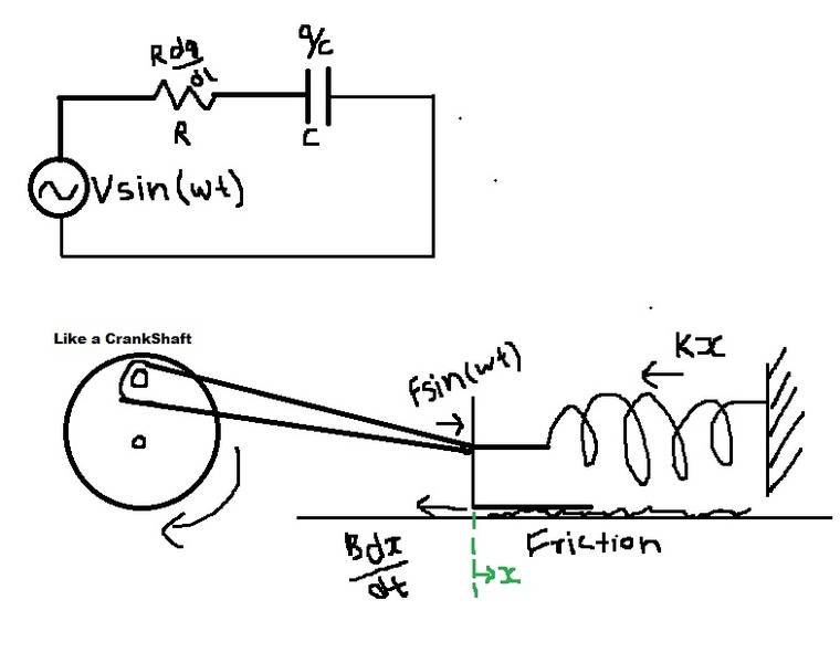

sophiecentaur, This is the last time I am going to say this point.
Am am NOT saying I CANT do the maths. I am not saying you DONT need maths. I am NOT saying I am stuck with the maths.
I am saying that ONLY using maths is not the way to get a full understanding.
As I've already demonstrated, I CAN use the maths.
I completely agree you CAN NOT design systems without maths.
Im saying that MATHS ON ITS OWN IS NOT going to explain what is happening.
The MATHS compliments an explanation of what's happening.
es1. I answered your question of explaining the geometry problem without maths.
https://www.physicsforums.com/showpost.php?p=3381555&postcount=56
But no one has commented to say either they see my point or disagree. It just seems like its been skipped even though that's what you asked me to do...
As per my orignal question and my example on my previous post. I am not asking for an explanation why the "total phase" is -56.3 and not -51.2. I am also not asking for an explanation for why its exactly them numbers.
Im ASKING for an analogy / explanation of what's going on to cause this effect. Then you apply the maths.
This seems to be the main problem. It seems like most people who are posting really are just posting what they think they have read.
Sometimes it seems like no one is actually reading my posts and just skipping big chunks which is why we are going round in circles sometimes.
So for everyone whos just jumped to this page.
This post explains it the best.
https://www.physicsforums.com/showpos...3&postcount=19
Then read this post
https://www.physicsforums.com/showpos...3&postcount=48
It has a nice big picture.
So, in my big picture...my first drawing. Is that acceptable?

  • #75
IssacBinary said:
Exactly! And what you just explained was not my orignal question. I have said many times I UNDERSTAND the phase inside the capacitor.
Also many times I have explained my question and what I do want explained.
OVERALL PHASE SHIFT.
https://www.physicsforums.com/showpost.php?p=3377063&postcount=19
Then read this post
https://www.physicsforums.com/showpost.php?p=3381323&postcount=48
You mean if you had an RC circuit you want to know why the Phase is shifted at a certain angle (other than 90 degrees) and how that circuits resistance capacitance values account for a shift in overall phase?... but you want a purely physical explanation of what's happening?... I don't think you will find one.

wbeaty said:
The question is, is IsaacBinary basing his reasoning on the idea that "voltage causes current?"
IssacBinary said:
wbeaty, from all my learning and what I've been taught. I would have to say yes.
Then that's another conceptual sticking point. Yes, in resistors, voltage DOES essentially cause current (meaning that e-fields accelerate the resistor's mobile charges.)
It also works the same way for real-world metal conductors. The current in a wire is always caused by a (tiny) voltage applied lengthwise.
But inductors and capacitors are different. In these, the applied voltage doesn't directly cause current. L and C devices ...they're very weird.
IssacBinary said:
You can't have a current without a voltage can you?
Sure you can: a bunch of charges flowing in a ring-shaped conductor are analogous to a flywheel.
If you get this 'flywheel' going at high amperes, then disconnect it from everything, the currents persists for a time. If you used ideal zero-ohm wire, the current will continue forever, a flow without a voltage. If you used actual realworld superconductor, the current will keep going, and only decay over billions of years. It's a kind of electromagnetic inertia, fast moving charges, zero drive volts.
IssacBinary said:
So is that understanding wrong?
Yes.
And also no. In capacitors and inductors, the currents and voltages are divorced from each other. It's easy to produce currents without voltage, and voltages without currents.
