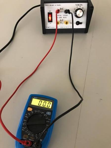

When I connect just the multimeter (as shown in the diagram) to the power source by inserting the lead into the mA connection and change the setting to read the current on the multimeter, it reads 0.
When I change the lead connection from mA to A, the power source circuit breaker breaks.
V=IR
So then I tried connecting the ammeter in series with a resistor it started showing some current.

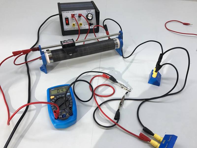

I later set up the new circuit with a rheostat, as shown in the second picture (with a diode and resistor in series with each other and another resistor parallel to it), and I tried changing the resistance using the rheostat, the current wouldn't change. Whether the diode was forward or reverse biased, it didn't seem to make a difference.
(I really hope that makes sense)
Thank you

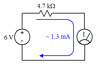

First: Never connect a current meter as you have shown in your first picture.
An ideal current meter is a short circuit (zero resistance) and will allow the maximum current to flow from the source. This may damage both the meter and the source.
If that were my meter, it would have blown the fuse for the mA range and that would explain why no current flows.
When you change to the A range, there is a larger fuse in the meter, so that did not blow and the supply was allowed to provide it's maximum current. Fortunately your supply seems to have overload protection and it's circuit breaker tripped.
When you use a current meter (or multimeter on current range) try to think, what is the maximum current that could possibly flow? Then start on a range greater than that. If the current shown is low enough, then you can switch to a lower range, but still greater than the maximum indicated value. So for example, if your milliamp range has a maximum value of 1999mA, and the Amp range shows 1.567A, then you can switch to the more sensitive mA range. But if the Amp range shows 2.123 A, then you cannot use the mA range. (In some cases you may find that the max current is more than your meter can handle - so don't use your meter, find one that can handle the max current, or don't do the experiment.)
Your first experiment seems to be intended to measure the short circuit current provided by the supply. It is labelled "max current # Amp", which I can't read but may be 2A, 3A or 5A? So you should have started with a meter (set on a range) that could handle that current, probably plus a decent margin (25%) for tolerances. This is not really an experiment for inexperienced people to do! Applying a short circuit (ie. amp meter) across a power supply is risky.
Your second experiment is hard to see through the tangle of wires. Perhaps. as I see gneill has now suggested, you could show the diagram of the intended circuit?
It looks to me as if the rheostat is not controlling the current through your diode. The rheostat seems to be in parallel with it, so the PSU is applied directly across the diode circuit. Also, it would help to know the values of your resistors.

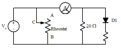

Thank you for your replies. It makes a lot of sense now. I've attached the schematic for you to have a look at.
The experiment asks us to use resistors of 100 and 220 ohms but we only have 4.7 kilo-ohms and 5, 10, 20 and 50 ohms.
So we used the 25 ohms resistor in series with the diode and the 50 ohms resistor in parallel to the two. We could attach these in series to give the 100 and 220 ohms they want but the connection was getting much crazier that way.
My question basically was what am I doing wrong with the rheostat and the multimeter which is acting as an ammeter?

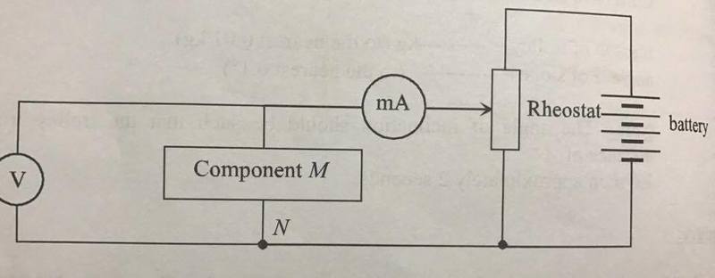

@Merlin3189 covered the use of ammeters and why it's not a good idea to place one directly across a voltage source.

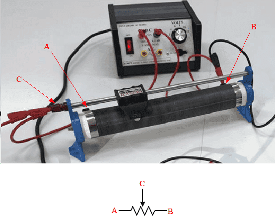

For the rheostat, you need to understand the connections on the device and match them to your circuit diagram. You've only used two of the three available connections, whereas the circuit requires the use of all three.
The rheostat consists of two main components, the cylindrical coil of resistive wire and the sliding contact. The connectors I've labelled A and B connect to either end of the coil (resistor) while connector C connects to the slider. I've placed a schematic representation is below the image.
The circuit in your lab drawing shows both ends of the "resistor" part of the rheostat connected to the power supply, while the image of your setup shows the power supply connected to one end of the coil and the slider. Effectively you've built this:
As you can see, the rheostat is not controlling the voltage delivered to the load.
I thought connect all three connections of the rheostat then it behaves as a potential divider. So it this particular experiment, it has to behave as a potential divider?
Is this my only mistake?
From what I can see from the provided circuit diagram it's the only connection error.

So we have to connect A and B to the source and C to the multimeter
Correct.
Can you just verify this for us, when we want to use the rheostat as a variable resistor we only make the two connections but when we want to use it as a potential divider we have to use all three connections?
Thank you for your help
That's true.

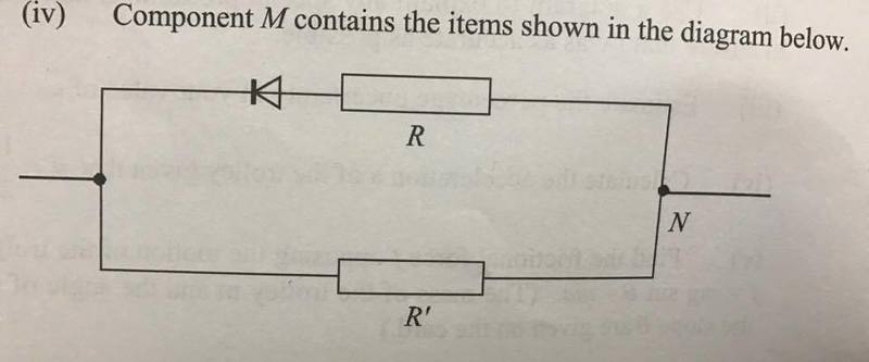

I wasn't too confident about it at first but then we started answering their questions. I'll just lay them out for you.
i) Connect the positive terminal of the battery and set the current to 16 mA. What is the voltage V1 across the component M?
We went along with 0.16 A instead of 16 mA and we got a voltage of 3.16 V.
ii) Reverse the component M and set the current to 32 mA. What is the voltage V2 across the component M?
We went along with 0.32 A and we got a voltage of 2.52 V.
iii) Component M contains the items shown in the diagram shown below (the schematic attached previously with the diode in series with one resistor and in parallel to another resistor). Use part (i) to find the resistance of the resistor R'.
This was the reverse biased connection so by theory if we assume that the diode did not allow any current to pass through then all the current went to the resistor in parallel and so R' = V/I = 3.16 V / 0.16 A = 19.75 ohms which is close since that resistor was 20 ohms.
iv) Assume the voltage drop across the diode is 0.60 V when forward biased. For the arrangement in part (ii) when the upper and lower part of component are conducting, find the following:
-current flowing through resistor R'
I = V/R = 2.52 / 19.75 = 0.127 A
- current flowing through resistor R
I = 0.32 A - 0.127 A = 0.193 A
-the resistance of the resistor R.
The voltage across R is 2.52 V -0.60 V=1.92 V and therefore R = 1.92 V / 0.193 A = 9.9 ohms which is very close to 10 ohms (the original value we were using for R)
