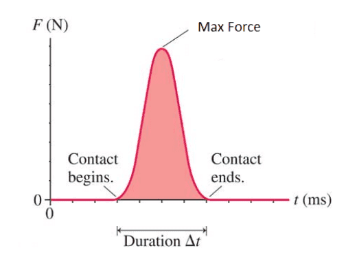

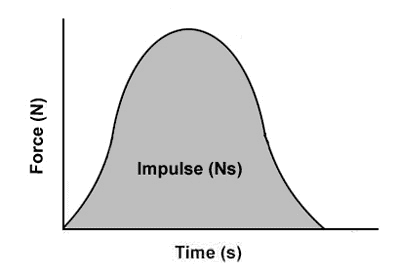

These might help
and if ##\dfrac{\mathrm{d}p}{\mathrm{d}t} = F(t)## then ## \displaystyle \Delta p = \int_{t_1}^{t_2}F(t) \mathrm{d}t##
Now one can define the average constant force of impulse as ##<F> = \Delta p / \Delta t = \Delta p / (t_2 - t_1) ##
i.e. ## \displaystyle <F> = \dfrac{1}{t_2 - t_1} \int_{t_1}^{t_2}F(t) \mathrm{d}t## which you might remember from calculus class.
