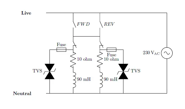

So now - if you'll please forgive being off topic from the original thread. Will the follow relay control circuit work for driving forward and reverse terminals of a gate motor ? I used the above link for my circuit design! Relays are connected for 'electrical interlock' meaning it should not be possible for both fwd and rvs terminals to be activated at the same time. Physically that is implemented as a jumper wire between the relay commons. If the fwd n/o is closed, the right hand motor will be connected and vv for the reverse. If both fwd and rvs are somehow activated at the same time, both n/c s will be open and there will be no connection to either terminal.
Design notes / recommendations on fuses and TVS diodes below are from Chatgpt.
Design Notes
Motors: 230 V AC, 0.5 HP induction motors.
Motor windings: 10 ohm resistance, 90 mH inductance.
TVS Diodes: SMCJ440CA — bidirectional, 440 V clamping.
Fuses: 500 mA fast-blow, 600 V AC rated — placed in series with each TVS diode.
Purpose: Suppress voltage transients across motor windings during switching by relays.
I have a problem making sense of how the "FWD" AND "REV" switches function. The way they are connected, the switches are connected in parallel so whichever is 'on', both coils will be activated. That horizontal line doesn't make sense. without some 'context'.
The key point is that if a normally open switch (one of the two at the top) closes, the corresponding normally closed switch (one of the two below) opens. If (say) the FWD (no) switch closes the nc on that side opens so current has no path to the left hand circuit. It must cross to the right via the connecting line and then through the (still closed) nc on that side to the circuit on the right which represents the forward motor winding. I should have labelled it as such. Current flows per red path or per green path below but the two paths are mutually exclusive. If both fwd and rvs (normally open) are activated at the same time, both normally closed switches will be open and there will be no current path at all between live and neutral. This is electrical interlock - it's similar to the way an XOR logic gate operates.

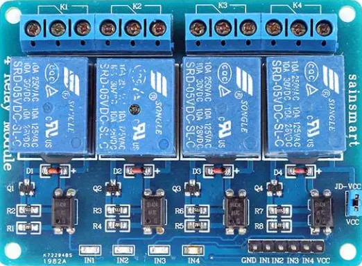

Edit: We decided our Sainsmart 4-channel relay set (albeit rated at 10 amp) is not suitable for driving an AC inductive load. So we're going to rather let it drive a contactor control coil. Which should reduce the load considerably. In case there's any confusion the Sainsmart relay is NOT the one I photographed above. It's this set:
AH; that makes some sense to me now. Those basic switch symbols actually contain a lot of 'extra' implied functions. I guess it may work ok for 'slow' logic but it seems to me that it introduces a potential logic hazard if the operating time for the switches vary. To make the diagram represent the actual situation, the switch functions should really be defined more fully. I would imagine this sort of practice would be very risky in vital equipment as it would be relatively easy to tidy it up with a better designed bit of (synchronous) logic.
The drawing is a little confusing but I seriously doubt it's any less safe than whatever is driving it.

If those two switches were not as you describe then the function of the whole circuit would / could be totally the other way round. It may work fine but what happens when someone introduces two different switches and is not aware of the spec? Those basic symbols are not sufficient. If you were to try to use an emulator to study what happens, how would the emulator 'fill in the blanks'?

That's fair enough but, on that diagram, there are two pretty vital elements that are not specified. The other components are specified well enough in as far as their relevant functions go. From your description, the way those switches work is very relevant, in a basic way, to the operation of the circuit. Make before break or the opposite could make a huge difference to how it works. That would be made clear in the parts list and in any description of the way things work so no worries but it raised an alarm for me, an ignoramus about automotive electronics. I guess it's basically a bistable / latching circuit.
I have never heard of a SPDT relay that is not break before make. It may exist and I've never searched for one, but I think it would be very uncommon.
As far as I can tell there is no latching. I believe we are to understand that the coils in the schematic are contactor coils that control the motor. They are not coils for the relay contacts in the schematic. The whole point of the circuit is to prevent both loads from being energized at the same time.

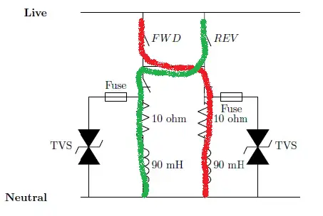

Again you talk of latches and flip flops when there is no such connection to cause this. I've redrawn it. It might make more sense. K1 and K2 coils are driven by some means. We are not told specifically what but as far as I'm concerned the voltage applied to them is independent of any contact position shown on the schematic. K3 and K4 coils are the coils for other relays not shown in this schematic.
No flip flop or latch action will occur.
Edit: I drew it a little different unintentionally. The original drawing shows the current crossing as @neilparker62 showed. My drawing doesn't have the NC relay contacts placed the same but electrically there is no difference.

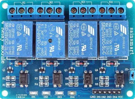

The relay set we are working with is the one in the pic above which I will repeat here:
Each relay has 3 output terminals: the no, the common and the nc as shown at the top of the board. They are just switches - nothing more , nothing less. Input pins showing at the lower right are driven from raspberry pi GPIO pins. There's certainly no latching or flip flop circuitry that my simple mind is aware of anyway!
Anyway the main query is about snubber circuitry since the relays are driving inductive loads. So I am just wondering what the current wisdom is about those. Just RC circuits ? Or TVS diodes ? Maybe even a combination of both ? We managed to melt an MOV (metal oxide varistor) which wasn't very clever! Probably did not calculate carefully enough the transient high voltage spike energy release. Now we've reverted to a simple RC series circuit and we're not seeing any arcing across the relay contacts. So it seems to be working.
That makes some sense now and it is a basic bistable circuit; that's all sorted then :smile: . This proves how important it is to stick to the conventions.
