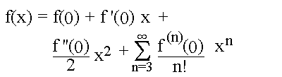

Use Maclaurin's theorem to estimate d[tex]^{2}[/tex]y/dx[tex]^{2}[/tex] at x=0
It's the deflection of a 2m beam, where x is the distance along the beam, y is the deflection in mm.
Maclaurin series expansion: f(x) = f(0) + f'(0) x + f''(0)/2 x^2 + sum from n=3 to infinity of f^(n)(0)/n! x^n.
I didn't know where to start so I tried to solve it a different way, by figuring out the formula for the sequence and then just differentiating it twice.. I got the answer of -200 or -0.2 depending upon if I needed to convert the mm to m?

You have y=f(x), so y''(0)=f''(0). If you can find the coefficient of x2, you can solve for the second derivative.
The expansion f(x) = f(0) + f'(0)x + f''(0)/2 x2 is the equation of a parabola. Fit your data points to a parabola. The coefficients you get will correspond to f(0), f'(0), and f''(0)/2.

So the answer is -200 then? Since y = -100x^2 + 100
So f''(0)/2 = -100
so f''(0) = -200
?? Or should I convert the mm to m?

No, it's not right because you left off the units! You always have to include units on physical measurements. For example, the length of the bar in this problem is 2 meters or 200 cm. The answers are equivalent, but you only know that because the units were included. A pure number is typically meaningless for physical measurements.
Regarding the units of y'', if y is measured in millimeters and x is in meters, you'd have the following units:
y => mm
y' => mm/m
y'' => mm/m2
Every time you differentiate, you're essentially dividing by x, so you get another power of meters on the bottom.
