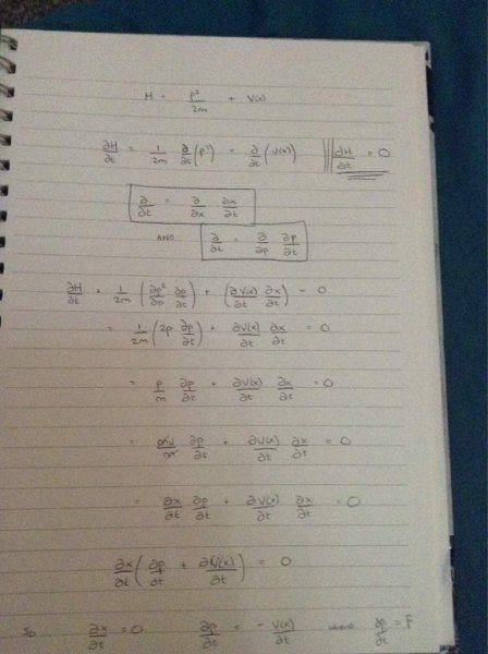

Hi all,
I'm not 100% sure this belongs in this topic but it was a problem I was given in a quantum mechanics lecture so here goes, sorry if I am wrong.Anyway I was given a hamiltonian H= T+VWhere T is kinetic energy and av is potential, and asked to use
dH/dt= 0
to find an analogy between it and Newtons laws, now my work is far to long to post using the usual method so I have attached a photograph of all my work I hope it is clear what I have done, I just want to know if this is the correct approach or I have somehow magically confused myself into what seems to be a reasonable answer :)
Thanks for any help

V = V(x) so ##{\partial V\over \partial t} = 0##. However, that's not what you have in your relevant equation. From that (and from any first-grader dimensional analysis) you want ##{\partial V\over \partial x}## there. Coming close to Newton already ?
So potential between that a and 0 is not 0?
I'm not sure I follow what you are saying?
He's saying there's a mistake in the fifth line of your work.
Ah I see it! I have dV(x)/dt
Rather than what I should have which is
dV(x)/dx
