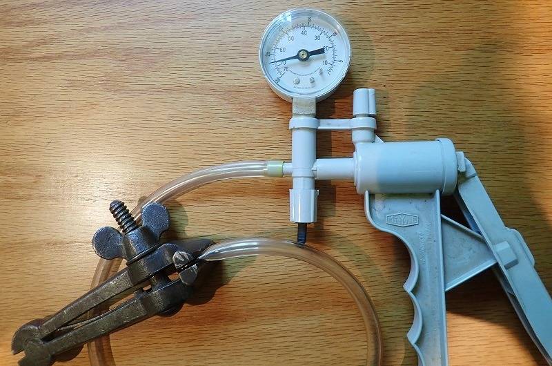

You can measure vacuum with a vacuum gauge. Amazon has many of them, search vacuum gauge automotive to find them. This is what a typical one looks like:
You can find out how to increase the maximum vacuum by getting a vacuum gauge, then experimenting.

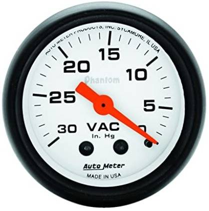

I looked on amazon and most of the pics have tubes. To be clear, the sensor is to be placed directly into the vacuum chamber and not attached to any tubes. Are the sensors able to perform this way or must they be connected to tubes?

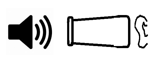

Correct yes.
Here is a drawing:
cylinder is slightly conish and has a maximum diameter (y value) of approximately 6 cm.I haven't yet tested it outside but maybe the problem is the sound is bouncing off walls? Or that a 10% atmosphere vacuum isn't enough to make an audible difference in sound?
The sound can still propagate via the solid walls of the container to get from the speaker to your ear. You would need to stick your head inside the vacuum to avoid any parasitic paths through solids to your ear (please don't try that at home...).

Steam, like air, is invisible. What you see when you boil water in an open kettle is fog. Fog is little droplets of water from steam that condensed to liquid.
A vacuum gauge shows the vacuum relative to the atmospheric pressure at your location. Water at 20 deg C boils at 0.7 In Hg (inches of mercury) absolute pressure. You need to calculate the absolute pressure from your vacuum reading in pressure units, not percentages. For example, the photo below shows a hand pump with vacuum gauge at its maximum vacuum of 27.0 In Hg. The barometric pressure, from the airport 4 miles away, is 29.98 In Hg. That's a standard pressure intended for setting aircraft altimeters. The actual pressure at my altitude of 1500 feet above sea level is 19.98 - 1.5 = 28.5 In Hg. The absolute pressure in the hand pump is 28.5 - 27.0 = 1.5 In Hg. That absolute pressure would boil water if the water was warmer than 34 deg C.

Um...what problem are we trying to solve again? If it's to block sound by having an Altoid box-sized vacuum somewhere near your ear, it's not going to work no matter how much effort you put into pumping it down.
Its somewhat bigger than an Altoid box, but what size is needed for a noticeable effect?
You can't do it.
a. The sound can go around the box.
b. The sound can go through the box's solid parts even if the rest of it is under vacuum
c. The human response to sound is logarithmic. Attenuating half the sound will be barely noticeable.
