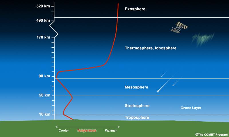

And that everybody will understand why it is complicated, here is an impressive image:
https://scied.ucar.edu/learning-zone/atmosphere/change-atmosphere-altitude
(UCAR at Boulder, CO)
I was kind of wondering what "And that" by itself meant! (For those who missed it, @fresh_42 posted that and then filled in)
If we were to do it over, we probably would not talk about "the atmosphere" as a single body. (Nor "air" as a single material) but there;s no sense crying over spilled terminology.
