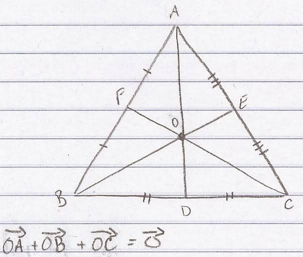

My teacher gave us this little problem a while ago to work on kind of as a brain teaser. He wanted the proof. I have never been too good a proofs so I never did it. I was going through my notebook and decided to see if you guys could help me, or point me in the right direction.
Like I said, all we needed to do was provide the proof, thanks
The problem doesn't make a whole lot of sense to me. Did you copy the problem correctly?
With vectors they often want you to prove a relationship like AB + AC = 2AD or something like that.
In that case, seeing as how “D” is the midpoint of BC, by parallelogram law you have:

We are going over it tomorrow in class. Its just nice to actually know the answer before he goes over it so then you can truly understand everything.
Just in case its not clear the last part is a 0 ZERO not a O.
I think your going on the right track. He said its VERY simple once you see it. I have searched google and have found nothing yet.
I will post the answer tomorrow after class (9:45pm EST) if its not figured out.
THANKS

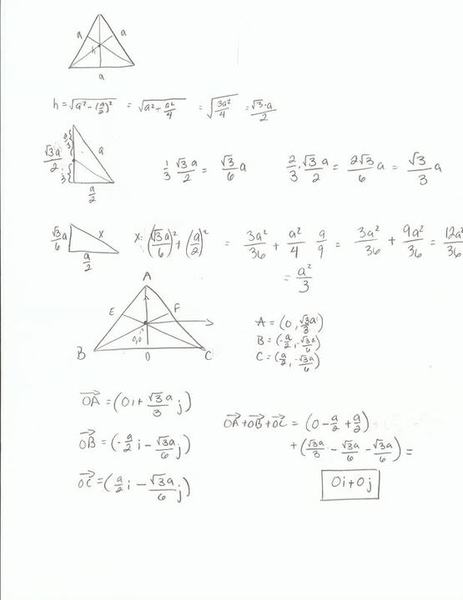

Ok so here we go. I got it finished today thanks to a little help from some friends in the math lab at my school.
What I needed to do was first find the height of the triangle.
I set the sides to a and then found the height using a^2+b^2=c^2
Then I used the known information that the center point is 2/3 of the way down from a point, and 1/3 from the bottom. Using this I could find the exact height of each section.
Then I needed to find the length from O to C which would also be the same length from O to B and O to A. I also use the a^2+b^2=c^2 to find this.
After that I put the origin at the center and figured out the coordinates for A, B and C.
Once that was done I made the OA, OB, OC vectors. Then I just merely added the i's and j's together and came out with 0i + 0j.
Hers is the work scanned into the computer.
