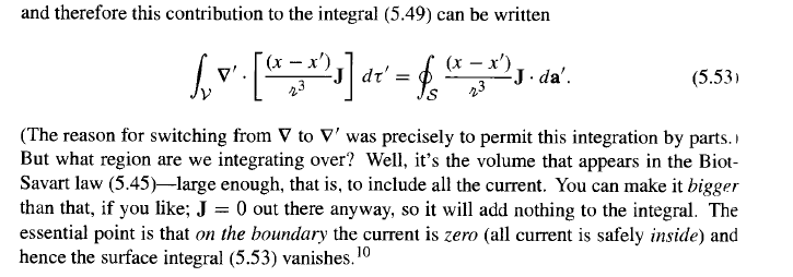

well from what i have seen in some texts is that the trick is to integrate over a volume larger than the body itself this extra volume would not contribute to the volume integral as the P is zero and hence the surface integral is also zero
i am not sure about this though
edit:
after some looking through i found that griffiths uses this trick when he derives ampere law from biot and savart law
would this apply here?
edit:
Yes I think this would work here too, however I feel there is something fishy about it, can't figure out what it is.
yes i have the feeling too something feels off about that
i think what it is saying is that surface charges don't exist if we were to take the divergence with sensible results there should be a continuous function if i am not wrong. so maybe like what it says is just that since outside P is zero for the polarization to be continuous since the E field is then the P has to taper off to zero at surface ie no surface charge which makes sense because initially we assumed bound charges is only divergence of P hence only volume charge.
if not then we also have to include surface charge in the bound charge expression from the start i think...
edit then in that we might have something like this
-\int x \nabla.\vec P d^3x + \int x \vec P.da = \int \vec P d^3x - \int x \vec P.\vec da + \int x \vec P.da = \int \vec P d^3x\\
since surface charge is ##\vec P.\hat n##

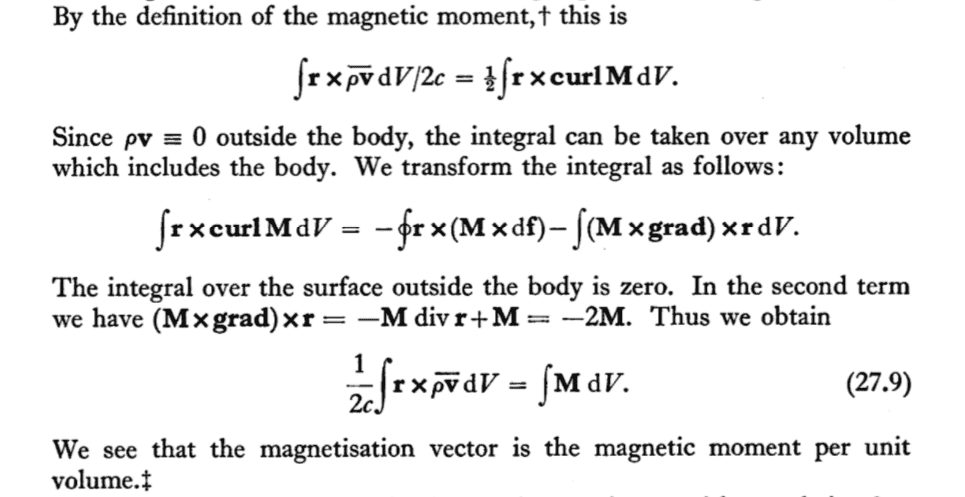

Ok I got it for ##P##, but the analogue for the magnetic field still eludes me... :cry:

My idea was nonsense. It's much simpler. Just use
$$x_j \rho_b=-x_j \partial_k P_k=-\partial_k(x_j P_k)+P_k \partial_k x_j=-\partial_k(x_j P_k)+ P_j.$$
Now integrate this over ##V##, use Gauss's theorem and assume that the entire chargd is completely contained in ##V##.
@vanhees71 but I already solved the first problem about electric polarization. It's the second that troubles me (the one about the magnetization vector)
BTW isn't your solution from problem #1 the same as mine and @timetraveller123's ?
Hm, despite a factor of 2 that's an identity. The magnetic moment of a current distribution is
$$\vec{\mu}=\frac{1}{2} \int_V \mathrm{d}^3 x \vec{x} \times \vec{j}(\vec{x}).$$
You can derive this using the vector potential in Coulomb gauge, [CORRECTED by a before missing factor ##1/c##!]
$$\vec{A}(\vec{x})=\int_{V} \mathrm{d}^3 x \frac{\vec{j}(\vec{x}')}{4 \pi c |\vec{x}-\vec{x}'|}$$
and expanding the integrand in powers of ##|\vec{x}'|/\vec{x}|##.

Btw I finally got the answer from my professor. Here's what he wanted.
From (the one and only) Landau Lifshitz vol 8 "Electrodynamics of continuous media" page 114
Although I still have to figure out how to prove the identity he uses... looks very unusual to me.
