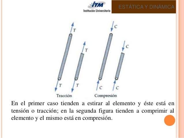

So it is not about whether they go outside or inside the bar, it is whether they leave the joint or not. I thought that in case for a bar that has two joints can be either in compression or tension whether they are going inside the bar or leaving it respectively. By this last thing I refer to this:
Diagram comparing tension and compression in a bar: two bars with arrows pulling outward labeled T for tension, and two bars with arrows pushing inward labeled C for compression, with Spanish caption.
This in Spanish means: in the first case they tend to stretch (pulling out) the element and this is in tension and in the second case they tend to compress (pushing in) the element and this is in compression. As you can see in the figure the force EF is pushing in the element with respect to joint E (I know that in joint F it will act the same so this is not my doubt) so how can it be a tension when the force is going in the bar and NOT out?
EF is pulling to the right on joint E. The joint E is pulling to the left on the bar EF. If you go inside the bar (i.e., put a fictitious break in the bar), the section to the right of the break will be pulling to the right on the section to the left. And the section to the left of the break will be pulling to the left on the section to the right. The key word in all of this is pulling. Pulling means tension. Pushing means compression. Or, if the tail of the arrow is touching the cross section, then you have tension, and, if the head of the arrow is touching the cross section, then you have compression.
