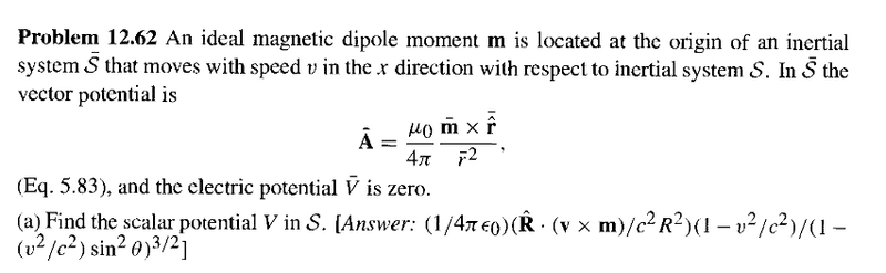

Hey guys. So, as i was going through Griffith's Electrodynamics, and i came across this problem:
Text from a textbook problem: Problem 12.61 on a magnetic dipole moment m at the origin of an inertial system S' moving with speed v along the x axis relative to inertial system S, with equation (3.181) referenced.
In the solutions:
Small handwritten-style equation image: a Lorentz transformation for a scalar potential, with the expression V = (V-bar + v A_x-bar) gamma and related terms written below it.
How to they actually get to that expression for V = (V(bar)+vAx(bar) )Ɣ? I understand everything after that, but this just made me very confused. How do they get this from the inverse Lorentz transformations?
Thank you.
  • Textbook problem 12.62 text: an ideal magnetic dipole moment m at the origin of an inertial system S-bar moving at speed v along x relative to S, with vector potential A-hat = (mu0 m x r-hat)/(4 pi r squared) and zero electric potential; part (a) asks for the scalar potential V in S.
The Lorentz transformation that goes from ##S## to ##\bar S## is given by the matrix:
$$\Lambda(S\rightarrow \bar S)=\begin{pmatrix}\gamma& -\beta\gamma & 0 & 0\\ -\beta\gamma &\gamma&0&0\\ 0&0&1&0\\ 0&0&0&1\\
\end{pmatrix} $$
The inverse is simply:
$$\Lambda(\bar S\rightarrow S)=\begin{pmatrix}\gamma& \beta\gamma & 0 & 0\\ \beta\gamma &\gamma&0&0\\ 0&0&1&0\\ 0&0&0&1\\
\end{pmatrix} $$
You can easily verify this by multiplying these two in any order and using ##\gamma=1/\sqrt{1-\beta^2}##. Basically it's the transformation with the velocity in the opposite direction, so ##\beta\rightarrow -\beta##, while ##\gamma## doesn't change since it's quadratic. If you take into account that
\bar A^\mu=\begin{pmatrix}\bar V/c\\ \bar A_x \\ \bar A_y \\ \bar A_z\\
\end{pmatrix} $$
and ##A=\Lambda(\bar S \rightarrow S)\bar A##, you should be able to get the desired result.
Thank you so much, it all makes sense now, even how to apply those!
