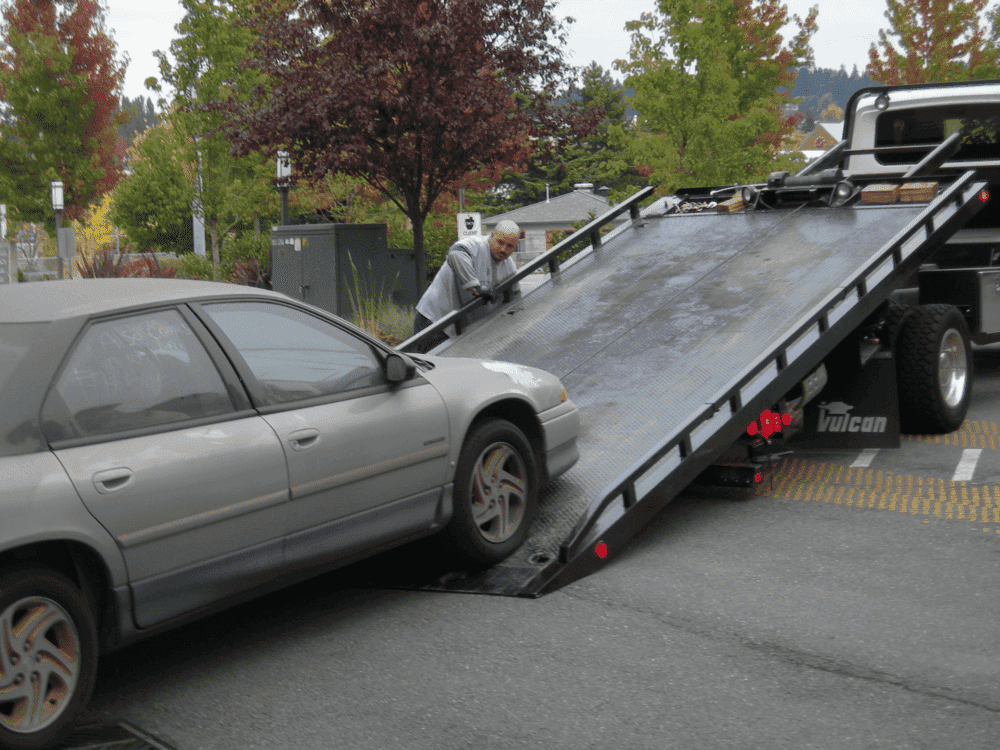

I would just put the vehicle on a tilt tray truck, then raise it to the required angle.
Great idea! I wonder if that 6-in-10 tilt is possible with most tilt-bed towtrucks. Also, the beds are usually metal, so I wonder if there would be enough traction for the truck's parking brake to hold it in the nose-down position...

A wooden bed would be needed if the tracks were steel, with rough timber placed across the ramp.
A tip-truck tray would be an alternative for testing a small 3 tonne tracked vehicle. It will reach a steeper angle than a slide-tray, and if installed as a fixed test rig, would not need the truck.
A tip truck tray has one possible problem. It may not have enough friction to keep the vehicle from sliding down with the brakes locked.
