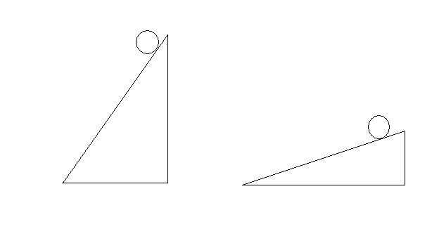

OK, so we know that the velocity is increasing. We also know that the value of the acceleration is decreasing. Let's work through this problem step by step.
IF the velocity is increasing, is the ball going down a hill (of some type) or up a hill (of some type)?
it is going down a hill...
OK, so we know the ball must be going down a hill, so any answer with "up a hill" can be eliminated. Now we need to figure out what the shape of the hill is (straight, curved in, curved out).
Next, what do we know about the acceleration? It's in the same direction as the ball and the value of the acceleration is decreasing.
In the picture below, which ball is going have the higher acceleration?
the one on the left...i take it you are leading up to the point of the shapes of the hills?
Correct. So, the stepper the slope, the higher the acceleration value is. We know that the acceleration value starts out high, and then decreases in value over time. Since the acceleration is decreasing, what does that mean about the slope?
that it is a large slope or hill soooo it would be the hill curving out?
Very close; I think you might be confused by what they mean by curved out and curved in.
Below is curved in(left) and curved out(right). Which one do you think is the right answer for this problem?
sorry, I was looking at it from curve compared to the atmosphere...the one on the left would have the decreasing acceleration?
Correct, so the answer for b is...
just so there's no more confusion, the answer for b is the previous graph on the left...meaning the graph that curves IN when looking from the graph out b.c the graph on the left has a less steep slope than the one on the right.
am I correct?
Yea. Since the acceleration decreases in value with time, that means the slope must decrease in value as well. The slot of the curved in starts out really high, then progresses to low.
