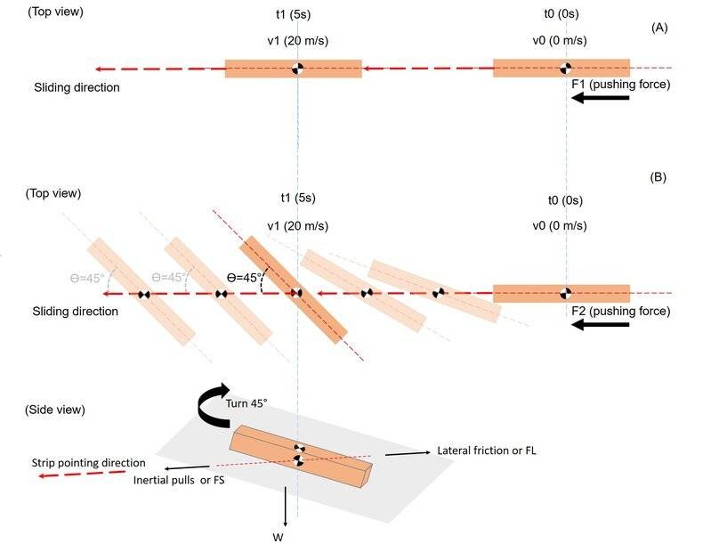

  • #32
Steve4Physics said:
Post #1 tells us that A and B have the same speed (v=20m/s) at the sane time (t1=5s). The question is about slowing down afer t1.
Well, that's how I read it.
I cannot read it that way:
"reach the same velocity (v1 = 20m/s) at the same time (t1, 5s), then we let them freely continue sliding. Object A slides while the sliding direction is along the longitudinal centerline of the object, object B slides while it rotates"
The sequence stated is
- they reach the same velocity, then
- continue sliding, while
- B rotates.
With your reading, there is no point in mentioning any active rotation. They might as well have been released at different orientations, but with no continuing rotation, in the first place.

  • #34
Steve4Physics said:
But that is exactly the point I made in Post #19!
I don't think so. The sequence I spelt out in post #32 is not contradicted by post #20. Let me extend it:
- B rotates until it reaches angle 45°, then
- continues at that angle
  • #35

Sorry if the question was badly written, I made it better to be clear for everyone.
Two equal metal strips (the same material, the same size and mass, mass for each one is 500 g, and size for each one is 50cm* 5cm) are pushed on a straight rigid surface to reach the same velocity (v1 = 20m/s) at the same time (t1, 5s), then we let them freely continue sliding. Object A slides while the sliding direction is along the longitudinal centerline of the object, object B slides while it starts with the sliding direction along the longitudinal centerline, and during t0 to t1 it gradually rotates about its central-vertical axis to make an angle (ϴ = 45°) between the sliding direction and the longitudinal centerline of the object, and with the fixed angle (ϴ = 45°) it continues sliding. Which object will stop sooner (which object will travel a shorter distance (d))?
  • #41
kuruman said:
I am a latecomer to this so forgive if I show unmitigated naiveté. I looked at the photo in #11 and read all the posts trying to orient myself. This is what think is the physical picture
Strip A is the control strip. At t1 = 5 s its CM has a speed of v0A = 20 m/s and it travels with its length along the x-axis until it stops.
Strip B is the subject strip. At t1 = 5 s its CM has a speed of v0B = 20 m/s along the x-axis while its longitudinal axis forms angle θ = 45° with respect to the x-axis. Its CM continues traveling along the x-axis while the rest of the strip rotates about its CM until it stops at some angle relative to the x-axis.
I base this interpretation because (a) the photo clearly has a time stamp of the two strips with the same velocities and different orientations; (b) angle θ is clearly labeled in the diagram and the text clearly mentions that θ = 45°; (c) the text mentions that the strips got to their respective orientations under the influence of the forces driving them ". . . then we let them freely continue sliding. Object A slides while the sliding direction is along the longitudinal centerline of the object, object B slides while it rotates about its central-vertical axis to make an angle (ϴ = 45°) between the sliding direction and the longitudinal centerline of the object.
The text in red is where there might be room for interpretation. Clearly, the sentence that begins with "Object A ##~\dots~##" describes the situation after we have let the strips to slide freely. Clearly, the text mentions that object B slides and rotates after the strips are allowed to slide freely. Clearly, the angle labeled θ at time t1 in the photo is given the value of 45° in the text. Putting all this together I concluded that, at time t1, strip B is translating while rotating and forms an angle with an instantaneous initial value of 45° relative to the x-axis. An alternative interpretation could be that at time t1 the initial angle is some θ as shown in the photo and the final angle is 45°.
Sorry if the question was badly written, I made it better to be clear for everyone. Please check post #40
  • #42
Hi@Javad. It would be clearest if the motion were described in time-order.
From t=0 to t1=5s: A is accelerated to 20m/s aligned as shown and B is accelerated to 20m/s while rotating.​
At t1=5s: B stops rotating with θ=45º as shown; the accelerating forces are removed.​
After t1=5s: A and B slide (with B’s angle θ=45º constant) and come to rest.​
Is that correct?

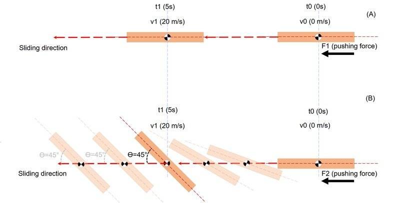

Javad said:
So that's your final answer, Thanks.
No. "does not affect" is not my final answer.
You are quoting a phrase from my Post #44 out of context. In Post #44 I said [my underlining added]:
“Rotation stops at 5s. How object B got to 45º at 5s does not affect how it moves after 5s.”
You still need to decide if the stopping-distance with θ=0 is less than, equal to, or more than the stopping-distance with θ=45º.
What do you think happens?

I think due to mass and fast rotation (that happens for object B), object B experiences inertial pulls in the opposite direction of rotation at the center of mass thus the object would have the tendency to skid towards the opposite direction of rotation (probably it is the actual heading direction), while there is lateral friction for object on the opposite side, therefore if the skidding force be greater than the lateral friction the object can slide but there is a waste of energy (velocity or force, actually I don’t know what!) in comparison with object A. (Please find attached image).
You have a misconception.
At t1, B has stopped rotating; it has no ‘memory’ of how it was rotating previously (between t0 and t1).
Suppose, there is another identical object, C which (at t0) starts with its angle θ=45º. C then moves, with no rotation, and at time t1, C is also traveling left at 20m/s.
At t1, the motions of B and C are identical. After t1, C moves in exactly the same way as B.
The ‘histories’ of B and C are different, but they are in exactly the same state at t1. So they continue to move in the exactly same way. Their ‘histories’ don’t have any effect.
The fact that B had been rotating earlier is irrelevant.
