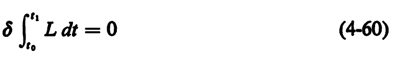

When is Hamilton's principle##\delta \int L d t=0## valid ?
Is it only valid for monogenic and holonomic systems? What about monogenic and non holonomic systems?
(I'm asking this because I got confused because I've found that Goldstein has got something wrong related to this in his 3rd edition)

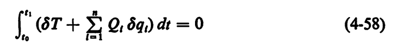

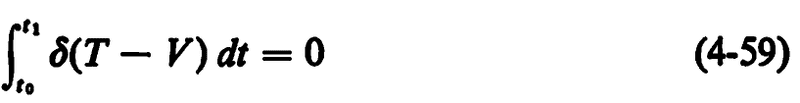

And we can extend it to one special case of non holonomic case as shown below?
andresB said:
If I remember correctly, last week I read an article that says that Hamilton's principle work just fine for non-holonomic if and only if the constraint equations are linear in the velocities. But I can't find the pdf at the moment.
by the way @wrobel , I'm interested in your opinion about this new(?) variational(?) principle of mechanics https://iopscience.iop.org/article/10.1088/1751-8121/ac2321/pdf
That's also in Goldstein. He too uses Hamilton's principle for a special non holonomic case where we have
\sum_{k} a_{l k} d q_{k}+a_{t t} d t=0
Greenwood mentioned above:
This is simply wrong! I don't know when the textbook writers started to make these wrong statements leading to the wrong vakonomic dynamics. In all traditional textbooks the d'Alembert principle and the action principle are equivalent for nonholonomic constraints. The only restriction for the action principle is that the forces should be derivable from a generalized potential.

So what is a stationary point of the functional and why does not it satisfy the equations of nonholonomic mechanics?
Here is a draft of a section from a short textbook which is being written by my colleague and me
I have never noticed the order of variation and the integral in Hamiltons principle. And it is just mind-boggling. Besides Greenwood, a reference that I just read on the topic and that might be of use is L.A. Pars "A treatise on analytical mechanics" chapter XXVI.
