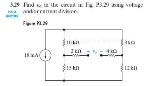

Find V0 using voltage/current division
V=(VsR)/Req
I=(IsIeq)/I
I used general circuit rules (parallel and series) to get the total resistance as 14.775 ohms{?}. And I'm stuck with what to do next . . .

[(10+3)//(15+12)] + 4 + 2 = 14.775
That's part one that's tripping me up. Part two is using the those division equations to find the source voltage . . .
So, by "total resistance" you mean the Thevenin resistance as seen at the open terminals. Okay. Be sure to include units on all results. All the resistors in your circuit have units of kΩ, so what should be the units of your result by the method you've used?
As for the current division, what are the resistances of the two branches that the 18 mA sees?
So yes, I'm in K-Ohms. The 18mA sees a 13 K-Ohm and 27 K-Ohm branch, correct? We haven't quite got to Thevenin in this class, or just ignored it maybe, but sure. From the vague recollection I have of it from last semester, learning from these forums.
Nope. Trace the paths that the current can flow from the current source, around a loop, and back to the current source. Remember that the Vo terminals are open: no current can flow across an open path.

You don't need any loop equations if you're going to use current and voltage division. You just need to identify the two branches in parallel with the current source that the current will flow through. You've identified one so far (the 10 k +15 k branch).
And is it legal to substitute V0R in for "i" across the resistors? I'm just remembering my notes and we did something similar though the context has been lost. But anyways, do 3 loops?
No, there's no current associated with Vo as it's an open circuit.
Just identify the two branches that parallel the current source and use current division o determine the current in each of them. Then you can play with voltage division to find the potential on either side of the open terminals, hence Vo.

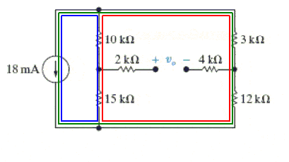

Here are the three possible loops for your circuit. Any two of them will produce linearly independent equations, the third will produce redundant information. Hint: You only every need enough loops so that each current-carrying component in the circuit is included in the path of at least one loop.
Here are the three possible loops for your circuit:

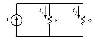

Consider the following circuit:
The current from the source, ##I##, will be divided into the two parallel branches as ##i_1## and ##i_2##. The branches have total resistances R1 and R2 respectively. One can determine the values of those currents from the total current ##I## and the branch resistances. Namely:
$$i_1 = I \frac{R2}{R1 + R2}$$
$$i_2 = I \frac{R1}{R1 + R2}$$
So you're in a position to determine the currents in the branches of your circuit. With those currents you can determine the potential drops across the individual resistors in those branches...
So i1 = 18mA(25KΩ/40KΩ) and i2 = 18mA(15KΩ/40KΩ)?

No, you didn't pay attention to which resistance forms the numerator of the ratio. Revisit post #14 and look closely at the expressions.

No, the numerators were the resistances of the other branch, the denominators were the total resistance of both branches. The current divider is an important concept, so it'll crop up in exams. Be sure to remember the procedure: The current in one branch is equal to the total current multiplied by the ratio of the resistance of the other branch to the total resistance of both branches.

The calculation is for the potential across the terminals where Vo is indicated. According to the figure, Vo is the potential at the left terminal minus the potential at the right terminal (the diagram puts the + of the voltage is on the left, the - on the right). So they calculated the potential at each terminal with respect to some reference node (the bottom node) and then calculated the difference in the potentials at the terminals.
The potentials at the terminals are the same as the potentials at the junctions of the resistors of the branches (since no current can flow through the 2 K or 4 K resistors). Choosing a common reference node (the bottom rail), they found the potential drops across the 15k and 12k resistors using the branch currents, and thus determined the potentials at those junctions with respect to that reference node.

You need to calculate the voltage at the junction of the 10k and 15k resistors. You also need to calculate the voltage at the junction of the 3k and 12k resistors. Then you subtract these two voltages, and there's your answer.
What I inferred (and it worked), was that each branch used current division to find the current through the branch. Then, using the branch currents, the "top and bottom" voltages were found (because V0 will be the starting point at each "upper" node of the branch)
