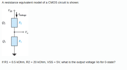

Voltage across R1 is Vsupply * (R1)/ (R1 + R2)
245653
I use the voltage divider rule as output voltage = Voltage across R1 = 5 * ( 0.5 / (0.5 + 20) )
This comes as 0.122 V
I'm not sure why they've mentioned I leakage and does 0-state have any impact on answer.
If that is supposed to represent a CMOS logic gate in 0-state, they haven't used a very representative value for the FET's typical OFF resistance, 20 kΩ!
They haven't mentioned anything else apart from the question. I think the FET will act as simple voltage divider.
Yes, the FETs form a voltage divider. But if the OFF FET was a more reasonable value (let's say, 20 MΩ) then you can see how a small leakage current could upset the resistive divider.

The leakage current is defined as the current thru the supposedly "Off" FET, Q2. (poor analogy, but like a leaky faucet that drips)
jaus tail said:
Problem Statement: Voltage divider rule for CMOS
Relevant Equations: Voltage across R1 is Vsupply * (R1)/ (R1 + R2)
The circuit given is a simplification of the output stage of a CMOS logic device. The 0-state reference would be to indicate that the output voltage should be a logic LOW level. The reference to Ileakage points out that devices in their Off state have a high but finite resistance, allowing a little bit of current to flow. The example circuit given has exaggerated the resistance of the supposedly Off FET to be a lower value than is commonly found.
I agree with your original approach and answer of 0.122V.
