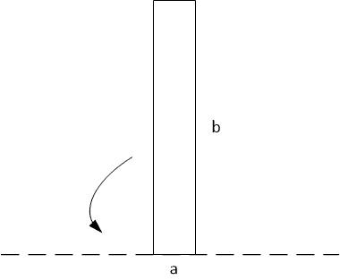

In that case (working the three dimensional integral into a one-dimensional integral): do you know the volume of a disk that is obtained by revolving a rectangle around one of its sides ? (disk thickness a and radius b when revolving around the x-axis in the figure below)

Maybe I confused you. The result of this revolution is a disk like this and that volume is relatively easy to express in a and b ...

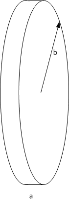

It's not an integral. It's a disk. I lost the picture, here it is again, with the question: what is the volume, expressed in a and b ?:

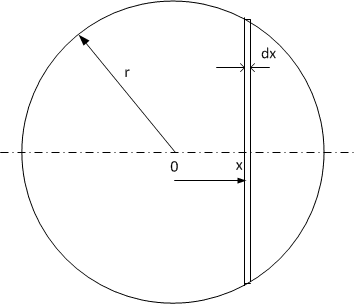

It certainly is ! Now we are going to slice a sphere with radius r into disks of thickness ##dx##. What will be the volume of the disk at ##x## ?

Perfect. Next step: we are going to add up all these disks from -r to +r and if we take the limit for ##dx\downarrow 0## we get an integral. Can you write down that integral ? (it's an easy question, because you have almost all of it already...)

yeah maybe ∫pi*(r^2-x^2)dx with integral limits from -r to r ??
Bingo
