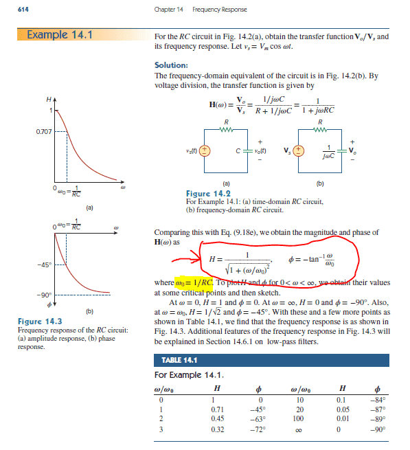

Example 14.1: For the RC circuit in Fig. 14.2(a), obtain the transfer function Vo∕Vs and
its frequency response. Let vs = Vm cos ωt
H(w) = Vo / Vin = |H(w)| ∟θ
Algebra/Trig for dealing with the Magnitude and Phase

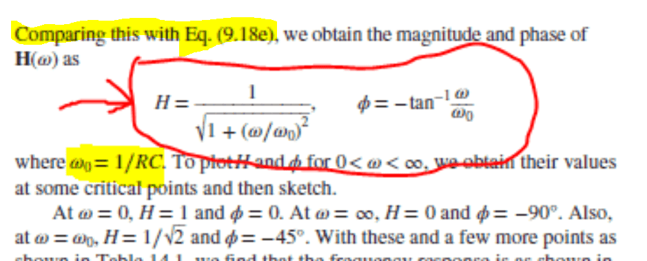

Here is the example and solution in full. I have circled where I'm at and highlighted the part that's tripping me up.
Textbook page showing Example 14.1: a frequency-domain RC circuit and the magnitude and phase plots of its transfer function, with the expression H = 1/sqrt(1 + (w/w0)^2) circled.
I managed to get...
Handwritten-style derivation of the magnitude |H(ω)| = |1/(1 + jωCR)| = 1/√(1² + (ωCR)²) and the phase angle arctan(0/1) − arctan(ωRC/1), with a note about converting to polar form.
and getting everything in terms of the angular frequency seems to be critical for getting the plots for the Frequency Response.
I checked my notes on RC, LC, and RCL circuits and I can't find this equation. I also checked my book.
I looked on Wikipedia and they seem to be getting this from A function G (gain?) but there's a lot of mention of Filters (Next section) and all the videos on Youtube were talking about Laplace Transforms (Section after next) so I'm having trouble understanding. https://en.wikipedia.org/wiki/RC_circuit#Frequency-domain_considerations
Hope that's not too much. I'm sure it's something simple but It's driving me up a wall.

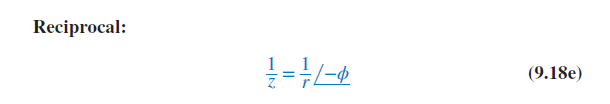

In the picture where it says "Comparing this with Eq (9.18e)", could you post a picture showing what Eq (9.18e) is referring to? (screenshot below):
Printed textbook passage with a red hand-drawn circle around the magnitude and phase formulas: H = 1 / sqrt(1 + (w/w0)^2) and phi = -tan^-1(w/w0), followed by text stating w0 = 1/RC.
Sure. Here you go.
Equation labelled Reciprocal: 1/z = (1/r) at angle -φ, shown as a complex number in polar form, equation number (9.18e).
I've been doing more research and I'm starting to think this has something to do with cutoff frequency. I'm going to look at getting the pols and checking it against that.
Are you confused as to how they got to the ##\omega_0 = 1/CR##? You could copy from your own results (hopefully that's your work in the image below the textbook screenshot) by setting ##\omega/\omega_0 = \omega CR## it's from your own solution... solve for ##\omega_0##... I think you'll be very surprised at the result ;)
If you're confused about why they chose that form putting with ##1+\omega/\omega_0## in the denominator what happens to the magnitude when ##\omega = \omega_0##? The graph in figure 14.3a it gives you a hint particularly at a some numbers along the y-axis it's a very common and special number.
Joshy said:
Are you confused as to how they got to the ##\omega_0 = 1/CR##?...
That is exactly what is confusing me.
Looking at it, if I set ##\omega = ##\omega_0 then the magnitude becomes 1/√2 which I just read is called the cutoff? (Brand new to this and LPFs are two sections from now). Did they chose RC = 1/##\omega_0 to achieve this number?
Correct! When you set ##\omega = \omega_0## it becomes ##1/\sqrt{2}##. After the frequency ##\omega## passes ##\omega_0## the magnitude of the transfer function ##H(\omega)## starts decreasing a lot approaching a very small number near zero. Notice prior to ##\omega_0## where ##\omega << \omega_0## it's much smaller, then the magnitude is still pretty close to ##1/1##.
So how to find ##\omega_0## for your circuit?
Copy it from your own equation right underneath where you said "I managed to get" and you have some equation for ##|H(\omega)|##.
Do you see from the textbook that it has an equation (the one you circled in red) that looks suspiciously like your equation? Here's what they have:
$$\sqrt{ \frac{1}{1 + \left ( \frac{\omega}{\omega_0} \right )^2} }$$
Here's what you have
$$\sqrt{ \frac{1}{1 + (\omega RC)^2} }$$
You could set your equation to equal ##1/\sqrt{2}## too, but... that little difference (on the bottom right of the equations) why don't you go ahead and set that part to be the same in both equations. Set ##(\omega/\omega_0)^2 = (\omega RC)^2## and solve for ##\omega_0##.
Are you feeling better about this? The homework section they don't allow us to just give answers...
I'm definitely feeling better about this. I still have a lot to understand but I'm kind of ticked that they used concepts from later in the book in the practice problem. I'm just glad it wasn't something I had already learned.
And thank you. I know they don't allow people to just give answers but getting hints and having more experienced people to tell you when you've found a sound answer helps a lot.
