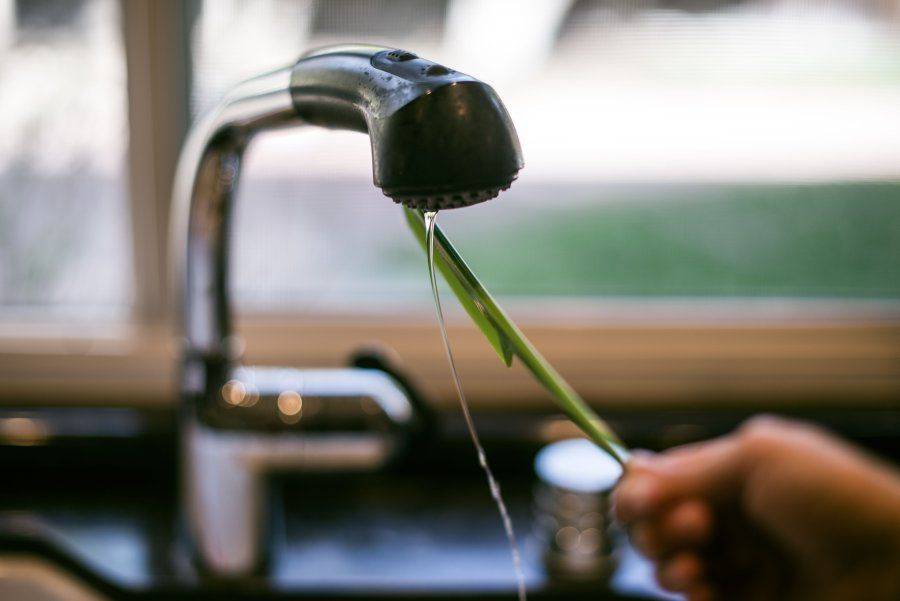

Sorry I'm not following. I'm referring to the picture from post #3. It's clearly a stream. Why are you talking about drops ?

(This is about the original 'comb' topic) There must be two things at work. For individual drops, any charge that they could get will be small, especially if they form at the tap (far from the comb) and the polarisation within the drop will produce less net force on the way past the comb. A continuous stream goes close to the comb and the 'polarisation' can involve 'the other' charges moving all the way to earth. Also, the experiment would look different if very pure water were used because it would only work by polarisation. This can probably be regarded as a difference in capacitance, which is much higher between the comb and a stream than between the comb and a drop.
The post you are querying refers to the Kelvin Dropper, which (the name suggests it) works on individual drops.
