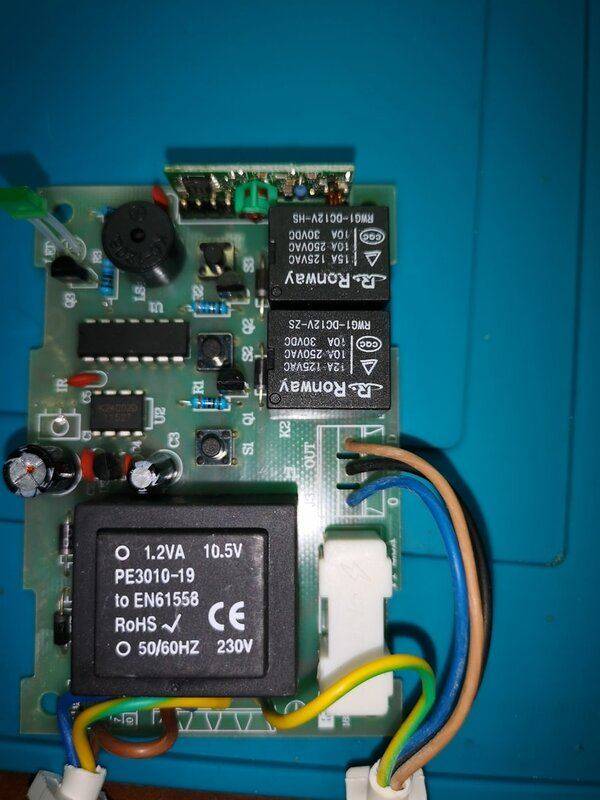

hi can anyone here recommend an alternative relay switch x2 one has 5 legs one has 4
im not able to find any the same :(
and the ones I've looked at all have 5 legs
the diffrece is Ronway RWG1-DC12V-HS
and Ronway RWG1-DC12V-ZS
Any help is appreciated :) hs and zs is the only diffrence i can see but no idea of the diffrence just the 5 leg and 4 legs.
The 5 pin relay is standard.
If you don't need change-over contacts, cut off the leg you do not need.

ok thankyou the bit that stumped me a little is the
15A 125VAC
10A 250VAC
10A 30VDC
non of what i find has the 10A 30VDC
cool thankyou but are these not two diffrent relays as one ends in ZS and the other in hS (HS being the four legged one) that's what made me think they are not the same ?
The relays are different. One is SPDT, and needs all 5 terminals on the package.
The other is lower cost SPST, so it is missing a pair of internal contacts and the pin that is not needed.
