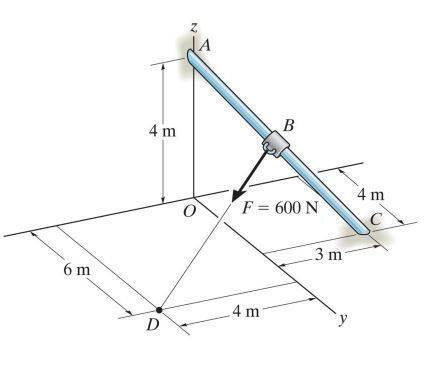

sevag00
80
Determine the components of F that act along rod AC and perpendicular to it.
Given: B is located 3 m along the rod from end C.
The problem is that the coordinates of B aren't given so I'm having some trouble in finding the vector components of F along BD. If someone can give me a hint in finding the coordinates of B.

Hint: The coordinates of A and C are given.
Still no clue. Is this related to Pythagoras theorem?
Sure, that'll work. Drop a perpendicular from B to the xy plane. Also draw line OC if it helps you to visualize the triangles.

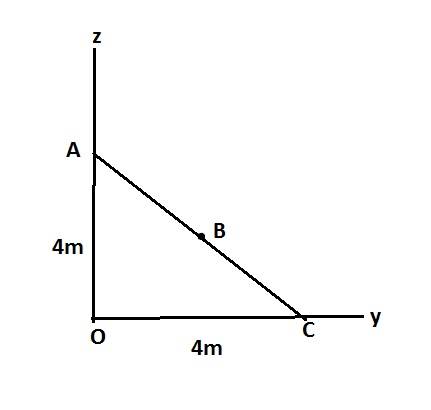

Let's do it one step at a time. Here is the triangle.
I'm not sure if B is the midpoint of AC. What do you say?
Also, I didn't get how the z coordinate of B is 3.
Also, AC=5.65
Harken back to your geometry classes; invoke similar triangles:

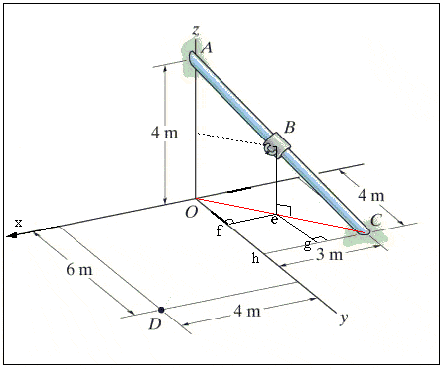

Here's the original diagram again with the force F removed for clarity, and additional annotations for easy reference:
The y-coordinate of B will be determined by the length of the line segment Of. the x-coordinate by the length of the line segment fe (and according to the directions of the axes, you want -fe).
Are we going to use similar triangles again?
Well, you get to choose the method. I've suggested using similar triangles, and Simon Bridge has suggested a vector approach. Either will get the job done, although Simon's is speedier and you will still need to use vectors to finish the problem.
OC = 5, I have Be and BC, i get eC. Then OC - eC = Oe
$$\frac{Oe}{Of} = \frac{AC}{AO}$$
We get Of. Then Pythagoras on triangle Ofe, we get fe.
Is this approach correct?
I wouldn't trust that angle OAC is the same as angle fOe without proof.
Instead I would look to guaranteed similar triangles Ofe and OhC. You know length OC (5), and you can find Oe easily enough from the way AC is divided into parts by point B.
Is this what you're saying?
$$\frac{Oe}{Of} = \frac{OC}{OH}$$
That would work just fine.
