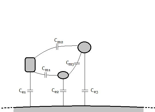

learnABC
Anybody please help to tell me if there's a book or journal that clearly describe the definition and differences ( best if it comes with illustration or diagram) between these engineering terms:
(1)partial capacitance
(2)mutual capacitance
(3)self capacitance
(4)earth capacitance
Thank you!

What is "partial capacitance"? I haven't heard that term before...
Suppose a system of any number of finite size, galvanically separated conductors placed at some distances from each other and at some distances from "infinite" or very large conductor. That very large conductor can be Earth (earth's equipotential surface), and this situation for 3 conductors and Earth is illustrated in the following pic:
Anylisis show that in electrostatic case there are 6 uniquelly defined capacities in linear dielectric medium. 3 mutual capacities between conductors (Cm) and 3 capacities of conductors to Earth (Ce). To my knowledge, each one of these 6 capacities is referred to as a "partial capacity".
