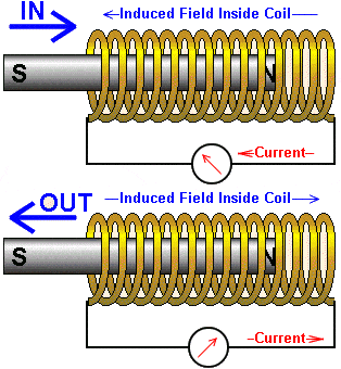

Look at the leftmost face of coil. Instead of clock rule , use Lenz's law. Imagine you are moving bar magnet in of solenoid. According to Lenz's law , the polarity of the left most face of coil opposes the motion of bar magnet. So polarity of leftmost face of coil is North pole. Magnetic flux will be from N.P. to S.P. of bar magnet with high intensity.
Similarly if you move bar magnet out of solenoid the polarity of the left most face of coil opposes the motion of bar magnet. So polarity of leftmost face of coil is North pole. Magnetic flux will be from N.P. to S.P. of bar magnet with little low intensity.

In AC :
IN DC :
