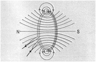

Yes ! I'm close to understanding , just could you please explain to me the part where "each turn acts as a magnet" ?I want to visualize it but can't seem to

You have to understand the nature of electromagnetism of the circular loop first, we can consider a circular loop as two STRAIGHT wires connected to each other. Each wire carries the same current but in an opposite direction, to visualize the magnetic field of the circular coil we will deal with loop as two connected Straight wires carrying an opposite current. By applying ampere's right hand rule on each wire, it is obvious that both magnetic fields "arising from what we consider two straight wires " have the same direction at the center of the loop forming a nearly uniform magnetic field, and by applying the field direction on both sides of the loop, you will realize that each side has a different polarity "where the field goes out at one side and goes inside at the other side". That's why you have to put in your consideration that the magnetic loop is a DIPOLE magnet it acts exactly like the bar magnet as it has a south and a North Pole
Let's get back to the the inductance coil.
Solenoids consist of circular loops connected to each other " in which there is a separating distance between each loop " when the magnetic flux falls on the solenoid, each loop responds independently to the magnetic flux change where an emf is induced in each loop, you can visualize this as batteries connected in series in a circuit where you add up their emfs.When a current flows in the solenoid each loop becomes magnetized affecting the neighboring turns with its flux

elmorshedydr said:
you have to understand the nature of electromagnetism of the circular loop first, we can consider a circular loop as two straight wires connected to each other. Each wire carries the same current but in an opposite direction, to visualize the magnetic field of the circular coil we will deal with loop as two connected straight wires carrying an opposite current. By applying ampere's right hand rule on each wire, it is obvious that both magnetic fields "arising from what we consider two straight wires " have the same direction at the center of the loop forming a nearly uniform magnetic field, and by applying the field direction on both sides of the loop, you will realize that each side has a different polarity "where the field goes out at one side and goes inside at the other side". That's why you have to put in your consideration that the magnetic loop is a dipole magnet it acts exactly like the bar magnet as it has a south and a north pole
let's get back to the the inductance coil.
Thank you so much , that was beyond helpful , that really helped me understand why they act as small turns , but there's only one question concerning the circular loop which confuses me , about the field entering the loop at a point annd exiting it at another , can you please explain it to me ? (the fact that a loop acts as a shortbar magnet)

At that time while solving the problem I didn't use the derivation , it didn't come up to my mind and when I saw it , I didn't know how it came to be like that so I took it as it is , but thanks , now I understand , because B of solenoid is nearly uniform so we can use a simplified formula specifically to calculate its inductance , while we use the general formula for the others because their B is not constant along their centers ,thank you so much , I'm really sorry for having troubled you much by asking numerous questions . Thanks a million again
ElmorshedyDr said:
Oh , now I get it ! You meant that the two poles are located along the flux in its center , I thought they were on the same plane as (the place where the concentric circles are crowded) thank you so much for the illustration , it was really helpful , thanks a million again !
