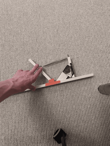

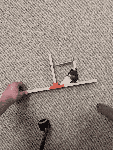

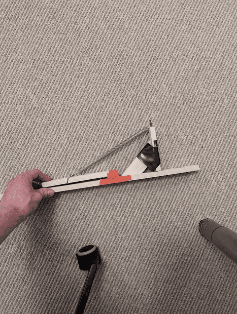

Im trying to calculate the velocity of a projectile on a catapult at different levels of stretch in the spring.
This is the catapult.
At equalibrium the spring is 0.09 meters in length.
When its fully stretched out its 0.225 meters long and I place a rock (0.205 kg) close to where my finger is on the catapult.
