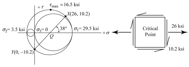

What determines the sign/direction of shear stress?
The direction of shear stress arrows in Mohr's circle is determined by the convention used in mechanics of materials. In standard practice, shear stress is represented as positive when it causes a clockwise rotation of the material element. This convention ensures consistency in analysis and interpretation of stress states. The discussion highlights the importance of adhering to established conventions to avoid confusion in engineering applications.

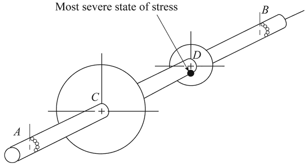

What determines the sign/direction of shear stress arrows in Mohr's circle? Please see pictures below. Why are the shear stress arrows drawn the way it is and not in the opposite directions?
I agree with you. It seems to me that they are drawn in the wrong directions.
