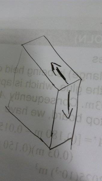

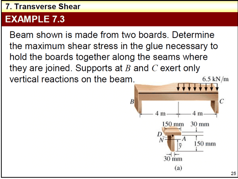

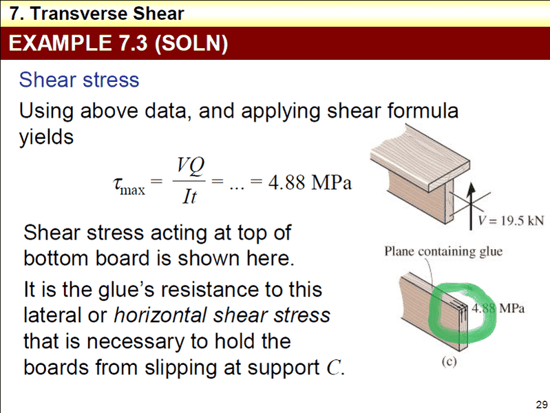

In the notes , i noticed that the shear stress on the top plane and the front plane will 'meet together' at the edge . I don't understand it why the direction is like that .
Is it possible for both the shear stress to become like this (opposite direction ) ? [/B]

say fonz you are not paying attention, by now you should know that every vertical shear stress VQ/It in the xy plane is accompanied by a longitudinal equal stress in the z direction in the xz plane.
