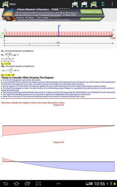

In the bottom left, why does the BM diagram start at -4kNm rather than 4kNm? I understand that if you make a cut you yield this result but if you don't make a cut how would you know whether it starts at -4kNm or 4kNm?
Thanks
By convention. They have assumed that a bending moment causing tension on top of the beam is -ve.
Aren't clock-wise moments assumed to be negative?
Two things:
1) I think you might be confusing the moment applied externally to a body with that of an internal bending moment. An internal bending moment is usually given a sign convention that depends on whether it causes tension on the top of a beam or on the bottom of a beam. In this specific case the convention adopted here is a bending moment is +ve if it causes tension on the bottom of the beam.
2) You can apply any convention as long as you are always consistent throughout. So if you define a clockwise moment as +ve than that is perfectly fine. Just don't switch back to a -ve clockwise convention later. That being said, you are right that a standard convention used by many is to assume a clockwise moment is -ve.

Nugso, the sign of a bending moment is not related to whether it is clockwise or anticlockwise. After all, if you were to go round to the other side of the beam, it would still be bending the same way. The test is whether the effect is a hogging or a sagging effect. Sign conventions vary around the world rather more than you would think, and there are fierce defenders of some of them. Think of whether the tension is on top (hogging) or underneath (sagging). If you are dealing with a column, then you will have to choose point of view (just as you do for a beam, generally viewed from underneath.
You can test yourself by https://play.google.com/store/apps/details?id=com.hakan.mnq.
You can see solution of the above question at attached pictures. This app shows you how can find function of shear forces and moments and draws diagrams.
