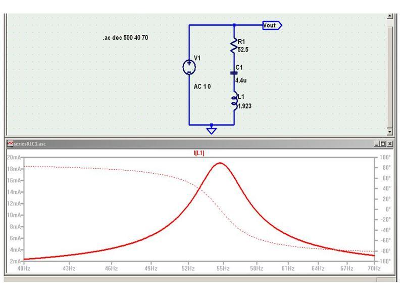

I think it's the next step where I'm missing something important. Now if you take that system and drive it at a frequency that is not w0 but somthing close how does the damping and Q effect the steady state solution? What I'm triyng to get at is, how does larger damping widen the resonance curve? of the forced response?
John
Hi John-
The attached thumbnail shows the forced resonance curve of [STRIKE]your[/STRIKE]a series LRC circiut vs. frequency using a constant voltage source (= 1 volt). The maximum resonant current is about 19 milliamps. The dotted line shows the phase angle. The phase angle is zero at about 55 Hz.

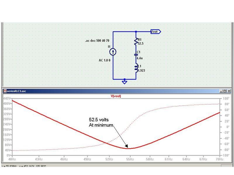

[Edit] Here is another thumbnail showing the forced-resonance response of the same series LRC circuit using a 1-amp constant-current source as the driving signal. Note that at the minimum (the self-resonant frequency), the output voltage is 52.5 volts, exactly the circuit resistance times the driving current. At other frequencies the voltage is higher, due to the added reactive impedance of the L and the C. The L and the C reactances cancel each other out at resonance.

  • LTspice screenshot: schematic of a series RLC circuit with AC source 1 and directive .ac dec 500 40 70, above a plot of I(L1) current from 2 mA to 20 mA and phase from -100 to 100 degrees over 40 Hz to 70 Hz, peaking near 55 Hz.
  • Simulation screenshot: series RLC circuit with AC 1.0 A current source, R1 52.5, C1 4.4u, L1 1.923, and a graph of V(vout) against 40Hz to 70Hz showing a minimum of 52.5 volts at about 55Hz, with a dotted phase curve.
